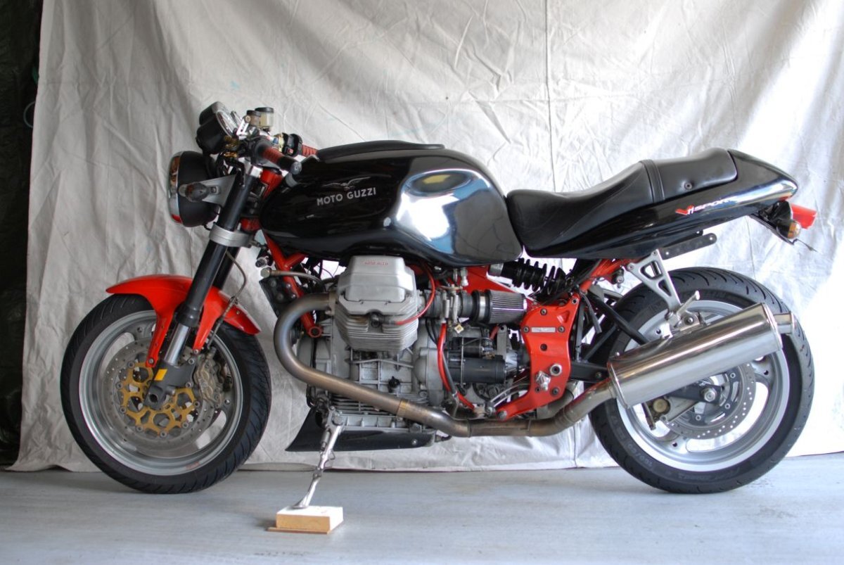

  6. My black 2001 V11 Sport is for sale in Seattle, WA, USA. **sold 1/31/24** This is a one-owner bike (always garaged) with clear title (WA. State) and 49K miles. The bike is largely in stock form and comes with a V11 shop stand, factory tail rack and bag, manual, spare key and various spares and parts. All maintenance and upgrades done by (the same) MG certified mechanic throughout its life. Fluids, battery, and tires are current. No oil or fuel leaks. More photos here: https://photos.app.goo.gl/g1qvQTfvw8zPeWfZA Forum member notes: - Staintune exhausts with map - Veglia’s all work - Original paint including pork chops - Front suspension has individual R/C controls (from Aprilia Mille RSV) - Hyperpro rear shock - PC-III - Shifter spring replaced at 30K (spare provided) - Rossipuro cardan bar (I have original) and bellypan - Tank is not swollen and chin pad is undamaged. Left and right rub marks visible on each side of tank from leg contact - Gel seat added under original seat cover (pillion cover included) Thank you

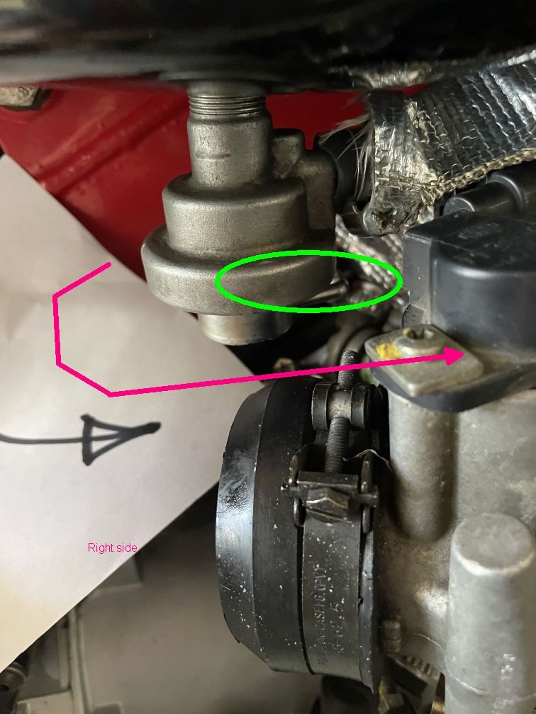

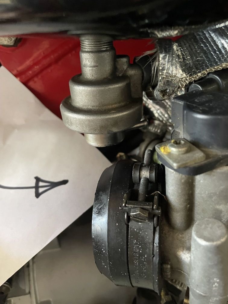

  11. Please clarify what "position" the rod/tiller should be in.....thank you
