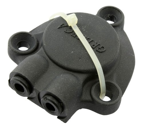

Lucky Phil Posted May 20 Posted May 20 5 hours ago, gstallons said: This does look to be correct. I know it lists Moto Guzzi but you would have to get it and see . Maybe Oberon could verify it fitting all V11s from 2000 til the end of production. I don't see how ot could be different. Problem is it's not just a matter of will it bolt onto the gearbox but also a matter of are the dimensions and piston travel exactly the same. The Oberon unit looks like it's for a Norge and Breva etc. I know when I updated to the single plate clutch I did some measuring and the length of the pushrod and the travel of the piston is highly critical. Whether the later model bikes use the same mechanical dimensions I don't know. I still suspect the low KLMs you get out of the original sintered friction plate for the RAM single plater when used on a V11 could be simply down to the clutch slave bottoming out as the clutch plate gets about 1/3rd worn because the RAM single plater was originally designed for the 5 speed with the cable operated clutch. Phil 2
audiomick Posted May 21 Posted May 21 10 hours ago, Pressureangle said: ...can anyone confirm fitment for prior years? I don't know why MG would have changed it later. I also can't imagine why it would have been changed. I went looking. Searching one of the part numbers quoted by Oberon, GU05086330, I got this at Stein-Dinse https://www.stein-dinse.com/de/moto-guzzi-kupplungszylinder-850-1100-1200-breva-griso/item-2-1030607-GU05086330-.html Looking at these parts lists, choose "clutch" from the index, part #13 on the apparently same drawing in all of them, I got the part number GU01086330 on all of them. https://guzzitek.org/parts_list/gb/1100/V11/V11Sport-RossoMandello_1999-2001_062011_PL(GB).pdf https://guzzitek.org/parts_list/gb/1100/V11/V11LM_Naked_2001-2002_052013_PL(GB).pdf https://guzzitek.org/parts_list/gb/1100/V11/V11LM_Nak_RC_NC_Cat_2003-2004_062013_PL(GB).pdf https://guzzitek.org/parts_list/gb/1100/V11/V11LM_2002_062011_PL(GB).pdf https://guzzitek.org/parts_list/gb/1100/V11/V11Cafe_Ballabio_2003-2005_062013_PL(GB).pdf So my opinion: Firstly, it seems that the V11 models did indeed all have the same clutch cylinder. Secondly, the clutch cylinder pictured from Stein-Dinse is listed as being for the "next generation", i.e. Breva, Norge etc., but looks remarkably similar to the clutch cylinder on my V11. So, even though the Oberon part is apparently not specifically listed for the V11 models, I reckon I'd be willing to take a punt on it. If only because it comes in such pretty colours. 2 1

Lucky Phil Posted May 21 Posted May 21 (edited) 27 minutes ago, gstallons said: I can't see there being any difference between the single plate and dual plate system on the hydraulics. No but there's a bit between the hydraulics and the pressure plate such as the pushrod length, and the pressure plate receiver for the pushrod. Also the clutch pack thickness has a relationship to the clutch slave cylinder travel in both directions. Imagine if the Oberon slave cylinder had less travel to the piston in the released or clutch engaged position. You could end up in a situation where when the clutch plate wears down and the piston is pushed further back into it's bore it bottoms out and then prevents the clutch from fully engaging.. I'd love someone to buy the Oberon unit and fit it so we know if it works for sure. Phil Edited May 21 by Lucky Phil 2
