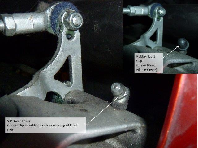

MartyNZ Posted August 29, 2016 Report Share Posted August 29, 2016 ...you can clean and lube the pivot at the same time...The previous owner of my bike added a grease nipple to the shift lever. I thought that this was a good idea for others to do at the same time as fitting the extended lever, so posted this picture. Also, I had slop on the inner bush of my shift lever, where I found that the pivot bolt was threaded too much, so the inner bush sat on threads instead of plain shank. The bush had grooves worn in it, and the threads were worn flat. I got a new bolt with less thread on it, and made new bushes. This improved shift lever action a little. 1 Link to comment Share on other sites More sharing options...
