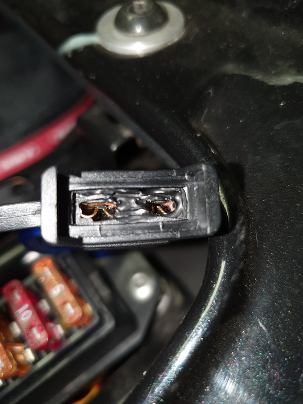

Tinus89 Posted October 11, 2019 Share Posted October 11, 2019 After reading this thread, as a precaution, I also installed a large automotive fuse holder with a 30A fuse in 2017. The holder was good for up to 40A fuses. In what I would call a routine check, I discovered this... I'll have a look at regulator + main ground, and I am sure she is not overcharging. Also no auxillaries connected aside from a GPS... Any ideas for a solution? Airplane style circuit breaker? Higher rated fuse+holder? 1 Link to comment Share on other sites More sharing options...
po18guy Posted October 11, 2019 Share Posted October 11, 2019 How do the wires themselves look? Would almost bet that it is a Chinese fuse holder. For some reason, their materials do not seem to be up to spec. Has anyone tried a Mosfet regulator? Over on the Kawi EX500 forum, they are the solution to fried rectifiers and cooked batteries. Even though Guzzi puts the rectifier (at least on my bike) right up front in the cooling air, they do need to shed a lot of heat. The Mosfet regulation seems to avoid that. 1 Link to comment Share on other sites More sharing options...

Tinus89 Posted October 12, 2019 Share Posted October 12, 2019 11 hours ago, docc said: Have you had an external charger hooked to the battery? I have, a Ctek XS 0.8, which only delivers 0.8A max... 12 hours ago, po18guy said: How do the wires themselves look? Would almost bet that it is a Chinese fuse holder. Wires are fine, it is really the contact between the fuse holder and fuse which get hot. The fuse itself was barely molten. I'm guessing it is Chinese, bought it at an automotive store. It is one of those watertight ones, which is nice, but also prevents any heat from escaping. Could something like this work? Dutch website, sorry... Link to comment Share on other sites More sharing options...

po18guy Posted October 12, 2019 Share Posted October 12, 2019 7 hours ago, Tinus89 said: I have, a Ctek XS 0.8, which only delivers 0.8A max... Wires are fine, it is really the contact between the fuse holder and fuse which get hot. The fuse itself was barely molten. I'm guessing it is Chinese, bought it at an automotive store. It is one of those watertight ones, which is nice, but also prevents any heat from escaping. Could something like this work? Dutch website, sorry... While it would work, there is still the underlying problem of excess voltage or excess resistance. I forget if you have checked battery and alternator voltage/amperage? Link to comment Share on other sites More sharing options...
Tinus89 Posted October 13, 2019 Share Posted October 13, 2019 I have checked charging voltage (fine, 13.9v and fairly stable). Battery voltage is 12.7v with the ignition off. I have not yet done any other measurements, suggestions to what I should check? Also cleaned the ground connections today (engine block+voltage regulator), the alternator connections and battery connections with Caig DeOxit. Spoke to a friended electrical engineer. In his opinion, close to 30A through the spade connectors of the fuse holder will generate some heat, especially if the connection is not properly maintained (guilty) and closed in into a watertight housing. His thought on the auto-reset fuse is that they generally do not like the amount of vibration a motorcycle gives, so he advised me to change the type of fuse holder for this design: The fuse is bolted between the two connections (he didn't have a 30A one for me, he'll order it). What do you people think?:) Link to comment Share on other sites More sharing options...
