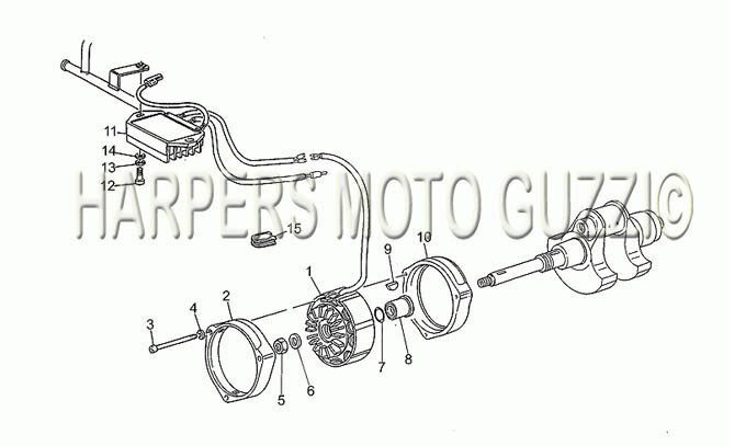

Pressureangle Posted November 8, 2022 Report Share Posted November 8, 2022 As an addendum, After installing my gears I developed a front seal leak. I blamed it on the seal, but it turned out to be the seal between the spacer and crankshaft. There's an o-ring inside the spacer sitting in a groove that I didn't see- which was hardened and came out in pieces- and on my '97 there is also a tapered relief in the crank end which was perfect to fit another o-ring as insurance. See # 7 & 8. 4 3 Link to comment Share on other sites More sharing options...
