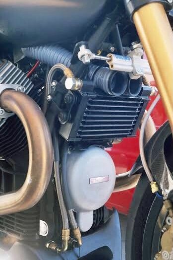

Re-reading docc’s aria! post the side view pic presents another option which if it proved too fiddly & is aborted (patience is limited!) - would be easily rectified by proceeding with said easy option elbow hack.
Maybe hacksaw a dozen parallel cuts around opening then splay out the intake ‘tags’ before remoulding with duct tape, fibreglass etc.
The Guareschi’s et al., favour CAI extensions - so these parallel cuts would also allow for insertion of literally any size width of tubing or pipe extension one wishes to suitably shove up there before clamping or duct moulding in - suggest diameter bigger than Italians...
Interestingly (scratching head), Guareschi’s ribbed intake openings really do appear smaller in internal  total area than what Phil A ‘s post discussed the throttle bodies require.
Where is their RR relocated making space for ribbed hoses?
Side chutes - still small.
