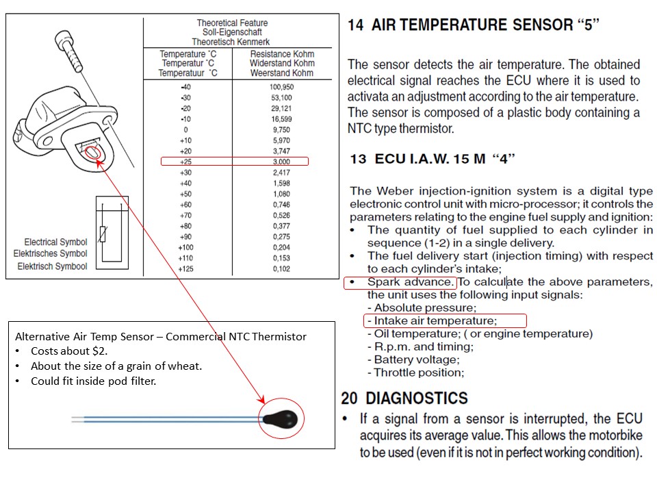

MartyNZ Posted January 28, 2022 Share Posted January 28, 2022 I have thermistors of the right value if that's what you need instead of the whole receptacle/connector unit. 1 Link to comment Share on other sites More sharing options...
laurent Posted January 29, 2022 Author Share Posted January 29, 2022 21 hours ago, MartyNZ said: I have thermistors of the right value if that's what you need instead of the whole receptacle/connector unit. That is very interesting thank you. In my case the actual receptacle is broken... Link to comment Share on other sites More sharing options...
