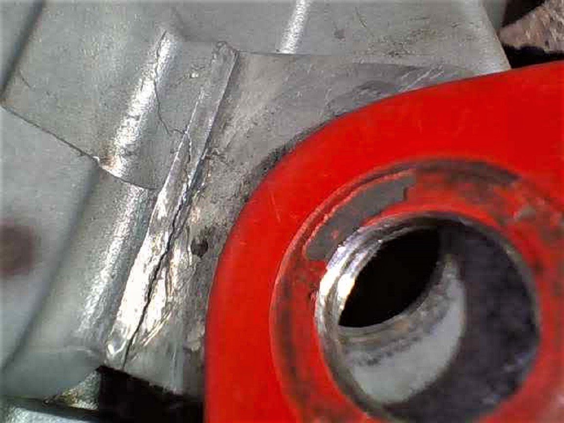

laurent Posted February 8, 2022 Report Share Posted February 8, 2022 Today working on my newly acquired V11 greenie, hoping to finish off doing the fluid replacements, I found the dreaded gearbox crack It is like all others I have read about around the upper mounting bracket on the Lh side, going from the bracket to the flat surface. I have mixed feelings at this time. The bike has 87000Km and is in good condition. My options.... 1. pump into the bike more time and money (new gearbox housing) or get the housing welded (outcome unsure) 2. find a second hand gearbox (difficult I think) 3. sell the bike for parts 4.close the garage and pretend it does not exist 5. ignore the problem and drive the bike until it leaks too much oil P.s.. for those who have been on this website long enough, the bike I got is Kiwi_roy's old bike (didn't buy it off him though) I really am looking forward to your inputs as I stand alone facing that dilemma at this time, what a bummer. L. 1 Link to comment Share on other sites More sharing options...

laurent Posted February 9, 2022 Author Report Share Posted February 9, 2022 21 minutes ago, LowRyter said: I got my GB case fixed. Of course the transmission had to be removed and taken apart- all beyond my skill level. For the fix, it was sent to powder coat oven for several heat cycles to clean out all the residual fluids and then welded. So far it's held up. The shop that did it for me sells a brace kit to prevent it from happening again. 2 hours ago, Lucky Phil said: The gearbox repair information you need is here. Ciao This is great, thank you. In the meantime here a few pictures of my 'crack'. I am wondering if someone didn't over tighten the bolt between the box and the frame... 1 Link to comment Share on other sites More sharing options...

laurent Posted February 9, 2022 Author Report Share Posted February 9, 2022 4 hours ago, Pressureangle said: If it's not broken through to the fluid compartment, I wouldn't even disassemble it. I haven't seen the crack-prone area, but if it's a dry crack in the bellhousing, I'd consider having it repaired in situ while it's bolted to the motor and cools to it's appropriate position. If you have more reason or desire to get the motor out of the frame, so much the easier. What's perfect, preferred, or a sufficient minimum are all different answers but don't serve the question, only your sensibilities. Mine run towards 'best utility with sufficient optics'. Anyone have a picture of a similar crack? It is leaking gearbox oil/cracked through 1 Link to comment Share on other sites More sharing options...
Lucky Phil Posted February 9, 2022 Report Share Posted February 9, 2022 3 hours ago, laurent said: This is great, thank you. In the meantime here a few pictures of my 'crack'. I am wondering if someone didn't over tighten the bolt between the box and the frame... This theory's been mentioned before and I'm not convinced this is the issue. I believe it's a micro crack initiated when the casting cools and is due to the sharp edge at this point and the large cross sectional change which causes a differential cooling rate. The crack then propagates over the miles and heating/cooling cycles. Yours is way worse than mine and well beyond any JBweld temporary solution. You may as well get it properly repaired because the chances of buying a second hand one that already has a latent crack is high. Part of owning an old classic like a V11. You need to do some "engineering" eventually and more often than not on a few different areas. To effectively repair this you need to chase out the crack with a die grinder and get it welded by someone that knows what they are doing. The idea is to heat the case to around 150 C before the welding starts and in your case half way through the weld repair stop and peen the weld to stress relieve the area and then finish it off and peen the finishing weld. It's not a complex scenario to someone that knows what they are doing. My gearbox mount showed no signs of any cracking, I just checked it because I'm a physco and knew of the issue. Seems it was a good decision. My original gearbox needs the same done to it as well. Ciao 6 1 Link to comment Share on other sites More sharing options...
