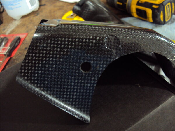

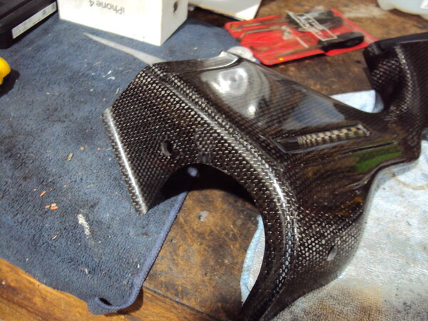

Lucky Phil Posted March 18, 2022 Report Share Posted March 18, 2022 4 hours ago, FreyZI said: So, I "need" a seat cowl, too. My Tenni came to me very well appointed in CF: front mudguard, gauges mount, fuel tank chin rest, alternator cover, side panels, hugger, and seat cowl. The only problem is that every piece of the CF is matte finish EXCEPT the seat cowl, which is high gloss. This bothers me immensely. Also bothersome, one of the POs turned the bolts too tight and cracked the cowl a bit; and there's a few other chips in the clear. I would like to source a matte CF cowl, but I'm guessing that's unobtainium. How many of us do yinz suppose it would take to make it affordable to get some made up for us? Seems a pretty easy job (for someone with the knowledge, skills, and tools, that is) -- one small piece, no corners, two holes. May have to start a new thread on this.... Thoughts? This is a no brainer seriously. Repair the cracking with some fibreglass repair kit if it's minor and possible on the back of the cowl. So a fibreglass repair patch to regain it's strength and fill any slight issues on the visible face with the glass resin and the sand it back with wet and dry carefully. For the matching matt finish buy a can of matt clear 2 pack and spray it. Quality carbon will always have a clear coat to protect the resin from the sun and all the differences are is if it's clear or gloss matt. I've done several carbon repairs this way and even patched carbon parts with carbon cloth scraps. I bought a set of carbon side covers from a member here and he had cut out a keyhole section of the L/H cover for a rear shock reservoir hose. I repaired it with some fibreglass resin and some scrap Carbon cloth I have laying around. I just put a patch on the back of the panel and let it dry then cut out a couple of keyhole shaped piece of carbo matt and resined it in place to fill the cut out and level it up. I didn't even bother with getting it perfectly flat with resin and sanding it back and shooting a bit of clear over it as it was so good I didn't bother. I've taken an image in the worst possible light and angle to show the repair and then a general shot of what you'd see from a foot away fitted to the bike. 99% of people wouldn't even spot it when fitted unless I pointed it out. Another hour of messing about and it would be nigh on a perfect repair. Almost no skill required and a $12 fibreglass repair kit and some give away carbon matt offcuts. Ciao 5 2 Link to comment Share on other sites More sharing options...

FreyZI Posted March 19, 2022 Author Report Share Posted March 19, 2022 BTW, @Lucky Phil, your repair on that side cover looks great. Link to comment Share on other sites More sharing options...
