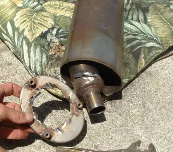

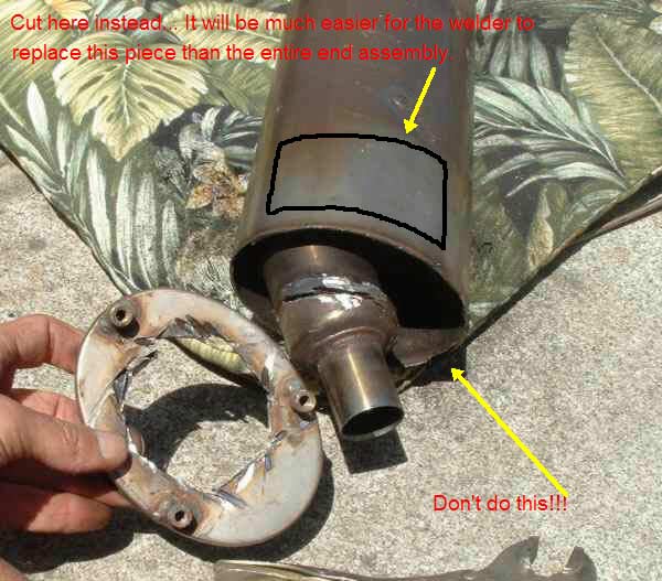

F344 Posted June 15, 2004 Report Share Posted June 15, 2004 photo 1 Before you start this, I have to say that it is probably a better idea to just go out and buy some other cans. I'm waiting on some TI cans from MG, but the dealer says they might take a while to arrive. I also got a spare set of cans on ebay for $75 so I decided to tinker. That said... here you go. BUT WAIT!!!!!!!! READ THIS... OH NO! I just talked to my welder and he suggested a different way to do this that is a million times easier.... Remove the sleeve just as I did, but then just cut a 3 x 6 inch opening in the SIDE of the muffler can near the rear. Then you can pull out the packing and the welder with have a simple job to weld the removed piece back in without all the alignment and tweaking that cutting the end off entails! Link to comment Share on other sites More sharing options...

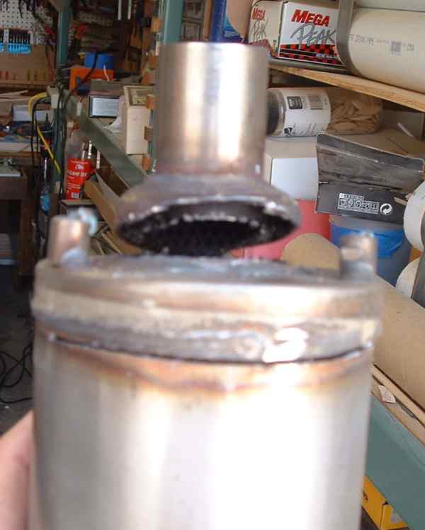

F344 Posted June 15, 2004 Author Report Share Posted June 15, 2004 photo 3 3. I found that tapping on the 1" exhauset outlet with a block of wood to cushion the lip worked better that trying to use the wood to tap the main plate surface. There is white fiberglass layered between the outside of the stainless can and the inside of the alum sheath. Do not get the fiberglass on you, it is very irritating. Use masking tap to cover and contain the glass as it becomes exposed. Link to comment Share on other sites More sharing options...

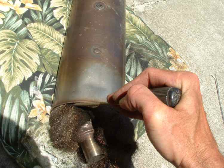

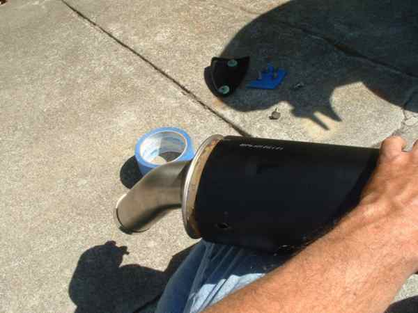

F344 Posted June 15, 2004 Author Report Share Posted June 15, 2004 photo 4 4. and 5. In these photos you can see the 2 welds you are going to have to cu through. The outer perimeter weld is easy to reach with a hand grinder. The inner perimeter weld is much harder to reach. Note the angle the inner pipe intercepts the outer plate. After having seen this on my first can I was able to do a cleaner job on the second. Link to comment Share on other sites More sharing options...
F344 Posted June 15, 2004 Author Report Share Posted June 15, 2004 photo 5 4. and 5. In these photos you can see the 2 welds you are going to have to cu through. The outer perimeter weld is easy to reach with a hand grinder. The inner perimeter weld is much harder to reach. Note the angle the inner pipe intercepts the outer plate. After having seen this on my first can I was able to do a cleaner job on the second. Link to comment Share on other sites More sharing options...

F344 Posted June 15, 2004 Author Report Share Posted June 15, 2004 OH NO! I just talked to my welder and he suggested a different way to do this that is a million times easier.... Remove the sleeve just as I did, but then just cut a 3 x 6 inch opening in the SIDE of the muffler can near the rear. Then you can pull out the packing and the welder will have a simple job welding the removed piece back in without all the alignment and tweaking that cutting the end off entails! I'm going to edit step one to mention this. Link to comment Share on other sites More sharing options...
