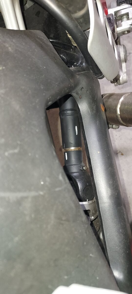

activpop Posted February 5 Report Share Posted February 5 While trying to remove rear section of drive line today I came across two concerning problems. First I noticed drive line reference marks were not lined up, which has me believe somebody removed it at one time and put it back willy nilly. The other thing is I assumed the two parts would separate easily because the splined male and female sides would have enough lube to just slide out, but that is not the case. I did put a little pressure on it and some taps with a wood block but if it moved it might have been 1/16" if at all. any clue to what is going on here or what i am doing wrong? I know this bike wasn't used much and was stored in a garage that remains quite moist during Oregon winters. Is it possible it is rusted? Link to comment Share on other sites More sharing options...

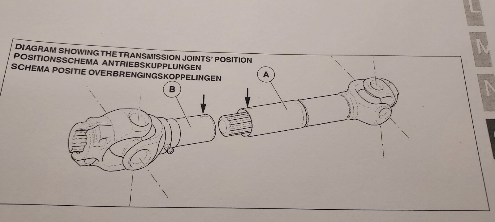

docc Posted February 5 Report Share Posted February 5 You can verify that the marks are correct by seeing that the trunions of the front and rear shaft yokes are aligned. [image courtesy of @Baldini]: And, yes, the rear should slide off. It makes me wonder of grease having hardened in there. How about some judicious heat from a heat gun or hair dryer (just remember to put it back before the wife reaches for it in the morning!) . . . 3 Link to comment Share on other sites More sharing options...
activpop Posted February 5 Author Report Share Posted February 5 I have both a hair dryer and heat gun on my rig, that was my next step along with maybe a shot of liquid wrench. Question, why in the left hand pic the caption reads marks aligned, but the trunnions definitely dont look aligned as in the right hand pic? That RH pic clearly shows index marks are mated correctly. Hard to tell on LH pic where the index marks are. Is that caption right? Trunnions are caddy wompus. Link to comment Share on other sites More sharing options...
docc Posted February 5 Report Share Posted February 5 2 minutes ago, activpop said: I have both a hair dryer and heat gun on my rig, that was my next step along with maybe a shot of liquid wrench. Question, why in the left hand pic the caption reads marks aligned, but the trunnions definitely dont look aligned as in the right hand pic? That RH pic clearly shows index marks are mated correctly. Hard to tell on LH pic where the index marks are. Is that caption right? Trunnions are caddy wompus. Baldini was showing the marks can be incorrect in the image, far left. Link to comment Share on other sites More sharing options...

activpop Posted February 6 Author Report Share Posted February 6 1 hour ago, andy york said: you might try hydraulics. Use your grease gun on the zero fitting and see if you can get it to move. If so , just remember to clean out some of the grease so you put it back together I got it out. A little tension and rapping with the rubber mallet and it came little by little. The rust on the outside of the female spline was the culprit, it was grabbing the interior of the tube it slips into. Double whammy here...bike sat unused and PO didn't believe in lubrication. I got rid of all the rust. What you are referring to as the zero fitting is the one on the tube exterior not the one inside the joint i assume. That one wont take any grease, plugged somwhere, have it soaking now to see if i can free it. Does that one feed the splines? One axis of the uni is smooth, the other isnt right. I hope I can get a replacement, will look now. Havent checked out front one yet. What did docc tell me...expect owner involvement? 🤔 Its all good though, I like things to be right and I like wrenching around. First guzzi for me but have wanted one for decades, sadly too many. Link to comment Share on other sites More sharing options...
