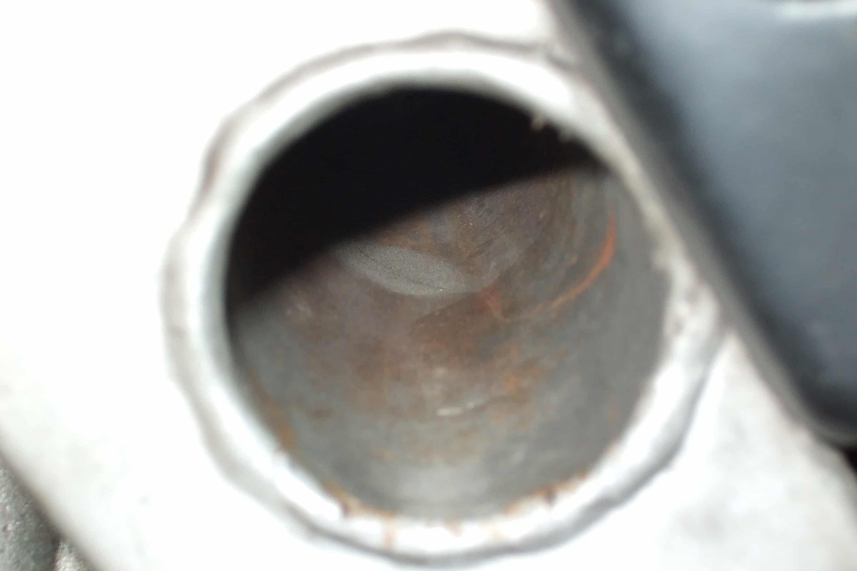

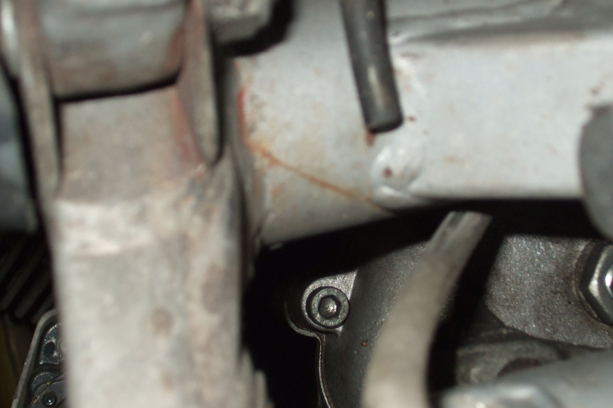

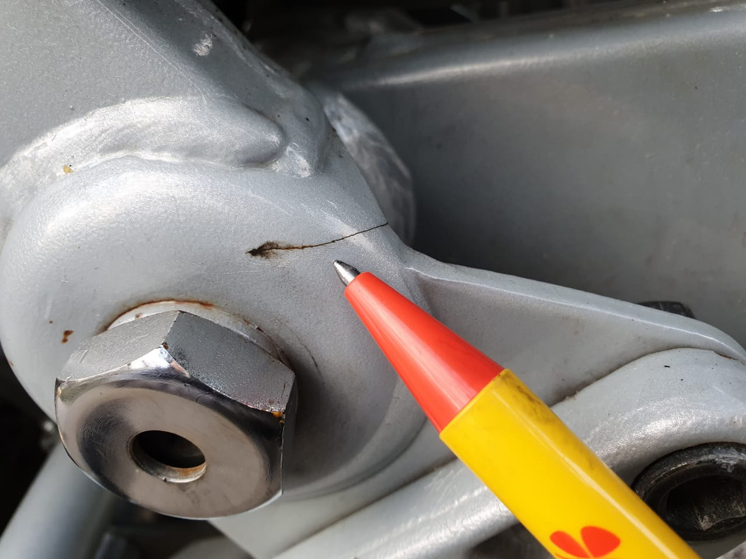

I found a couple of pictures in the german forum. I'll risk linking them here, as on of the posters would certainly permit it, and the other is no longer active.
From the first bloke with the comment "the frame has the usual cracks", it is a Quota 1000. He also commented that the 1100 frame is "immune" to the problem. This bloke is a vehicle engineer, and very knowledgable in Guzzi lore.
Not very good photos, but one can see what is meant.
And this from the second bloke, apparently a Quota 1100
So I would be having a very good look at the frame in those areas. :huh2:
Edit PS: further reading indicates that the second bloke's problem with the 1100 may have been a one-off, but the cracks in the 1000 frame seem to be a known problem.
