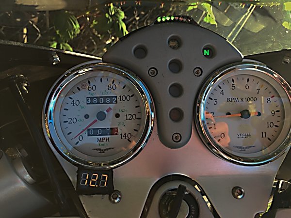

Art Posted July 12, 2023 Posted July 12, 2023 Nobody wants to be that guy going down the road with signals flashing. I have seen someone build an auto cancelling system using numerous sensors and microprocessors. I can solder LEDs. This is a problem for those who have installed LED signals. The stock indicator lamp will not work. Whoever installed the leds on my bike must have had a great memory, which didn't come with the bike. I'm experimenting with a super thin row of 8 leds that will sit on top of the panel. At some point I remembered that somewhere on this forum this problem was probably solved 15 years ago. 1

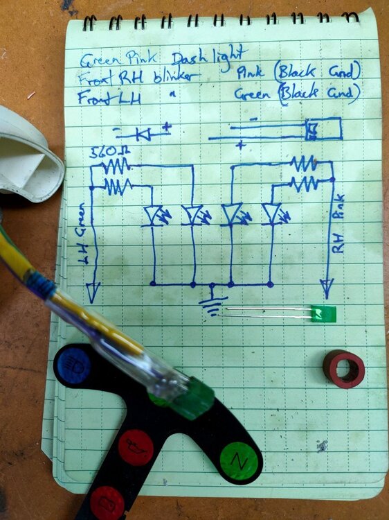

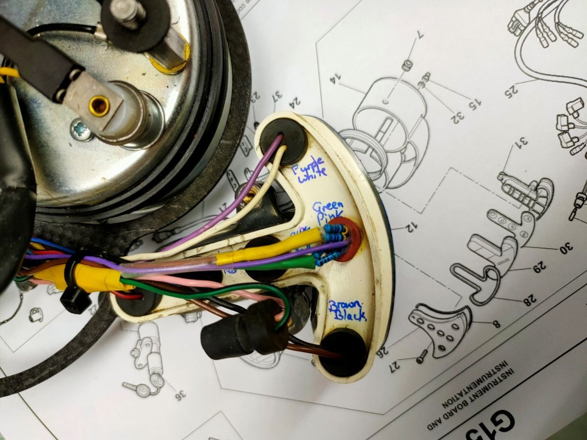

MartyNZ Posted July 12, 2023 Posted July 12, 2023 (edited) When I fitted LED indicator lamps, I needed an electronic flasher, since the current draw was too low to make the original flasher work. Then I found that the indicators on both sides flashed at the same time. Evidently the dash indicator light was providing a ground return through the other side lamps. I had to rewire the dash light as shown in the pics. EDIT1: The final version has 18,000 mcd (millicandela) LEDs with 360Ω resistors. EDIT2: Where "RH Black" is written on the circuit, it should read "RH Pink". Edited June 7 by MartyNZ Update 3 1
Art Posted July 12, 2023 Author Posted July 12, 2023 Thanks for the diagram. I'm basically doing the same, with 4 leds for left and 4 for right. I'm impressed you got it to fit in the original location.
MartyNZ Posted July 12, 2023 Posted July 12, 2023 6 minutes ago, Art said: I'm impressed you got it to fit in the original location. I filed off a lot of the encapsulating resin of square LEDs to make them fit. 3

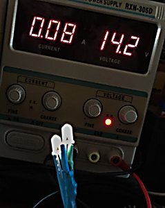

Art Posted July 13, 2023 Author Posted July 13, 2023 Using the MartyNZ wiring diagram I was able to use a single super bright white led for each side, and fit them in the proper place.
MartyNZ Posted July 13, 2023 Posted July 13, 2023 Just a comment about using a white LED behind a green dash panel lens. I believe that you would get a brighter and more noticeable dash indication if you use a green LED instead of white. A green lens filters out all visible light except green. Only green can pass through, and the rest is absorbed. So, all the light from a green LED passes through the lens with no loss, because it is only green emission. LEDs have a very narrow light emission spectrum (except white LEDs). Your white LEDs are most likely blue or UV LEDs with a phosphor over the emitter surface which glows (sort of bluish) white. Then only some of this white light can pass through the lens, assuming that the bluish white light has some green component to its output. There are two losses in this. 1/ Blue to white conversion inside the LED, and 2/ white filtered by the dash panel lens, to leave only green. This means that a white LED will be dim compared to a green LED when viewed through a green dashboard lens. The same logic applies to red taillight LEDs (better than white LEDs), and amber indicator lights (better than white LEDs). EDIT If those white superbrights are bright enough when installed, then ignore what I wrote above. 2 2

Art Posted July 14, 2023 Author Posted July 14, 2023 MartyNZ is correct about white Leds. The 2 small arrows are too small a surface to get much light through. I went with my original plan, which is very easy to see, even in sunlight. 2
