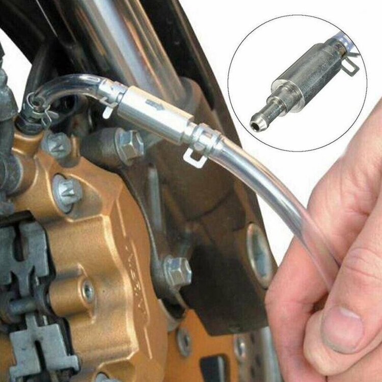

Speedfrog Posted September 19 Share Posted September 19 4 hours ago, audiomick said: The mechanic I go to uses a bit of hose with an inline one-way valve in it. You mean like this => 2 1 Link to comment Share on other sites More sharing options...
LaGrasta Posted September 19 Share Posted September 19 @Speedfrog Once I discovered this tool over 20 years ago, I use it for everything, clutch, brakes, cars, bikes, etc. It works so great, super easy. 1 Link to comment Share on other sites More sharing options...
audiomick Posted September 19 Author Share Posted September 19 7 hours ago, Speedfrog said: You mean like this => Yes, just like that. 1 Link to comment Share on other sites More sharing options...
Speedfrog Posted September 20 Share Posted September 20 8 hours ago, LaGrasta said: It works so great, super easy. And only cost a few bucks...(Guzzi content) 2 Link to comment Share on other sites More sharing options...
