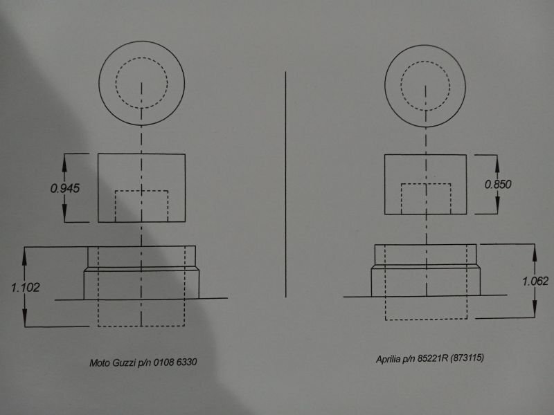

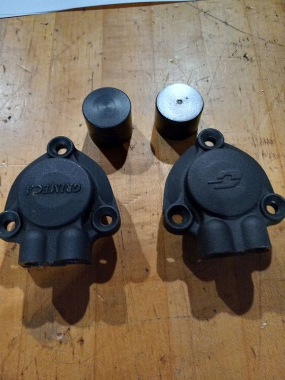

Cold Desert Rat Posted November 3 Share Posted November 3 The exterior dimensions are identical. The bolt circle, body diameters and steps, bores, etc. The Aprilia part only uses one port. One would need a banjo bolt with a bleeder on it. I find that acceptable There are some other differences. 2 Link to comment Share on other sites More sharing options...
Cold Desert Rat Posted November 3 Author Share Posted November 3 I only dimensioned the differences Oddly the cylinder off my bike had no spring It fits like it should on the trans. 1 Link to comment Share on other sites More sharing options...

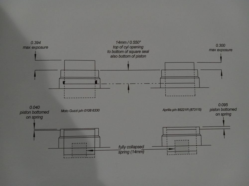

Cold Desert Rat Posted November 3 Author Share Posted November 3 A drawing showing how much travel. I assume the bottom of the piston never comes past the bottom seal. 2 Link to comment Share on other sites More sharing options...
Cold Desert Rat Posted November 3 Author Share Posted November 3 A company called Oberon makes a billet version, lifetime warranty, p/n CLU-2800 The smart guys on here will determine if the stock pushrod will work. I have to make a new one anyway, so it's irrelevant to me. We knew somebody else had to use that cylinder 1 1 Link to comment Share on other sites More sharing options...
