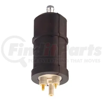

Tom in Virginia Posted May 26 Author Posted May 26 (edited) Just to note, out of interest to others, I did find what is supposedly the original fuel pump, with proper insulator, but $426 was just too much. (Edit addition 5/26) Found the same on Amazon for $154.07. Ordered, appears same as OEM with proper boot insulator/size). Will update upon receipt/comparison/install). https://www.finditparts.com/products/4474423/hella-7-dot-21287-dot-53-dot-0?srcid=CHL01SCL010-Npla-Dmdt-Gusa-Svbr-Mmuu-K4474423-L255&srcid=CHL01SCL010&utm_medium=cpc&utm_source=google&utm_marketing_tactic=broad&utm_paid_search_intent=vendor-brand&utm_campaign_id=21341868715&utm_ad_group_id=&utm_ad_id=&utm_platform=x&utm_placement=&utm_keyword=&utm_target_id=&utm_match_type=&utm_feed_item_id={feed_item_id}&utm_extension_id={extension_id}&utm_location_interst=&utm_location_physical=9008863&utm_product_id=4474423&gad_source=1&gad_campaignid=21331715424&gbraid=0AAAAAD1MMz7k9_oAlCNO_WKd-qFrOGTnT&gclid=Cj0KCQjw_8rBBhCFARIsAJrc9yDhhyVhWvnaWMJwtAhdIkYZUpnlpd1_YM47mxI3yHdRHRQphAtWoVoaAhmaEALw_wcB Edited May 26 by Tom in Virginia docc added image 2
