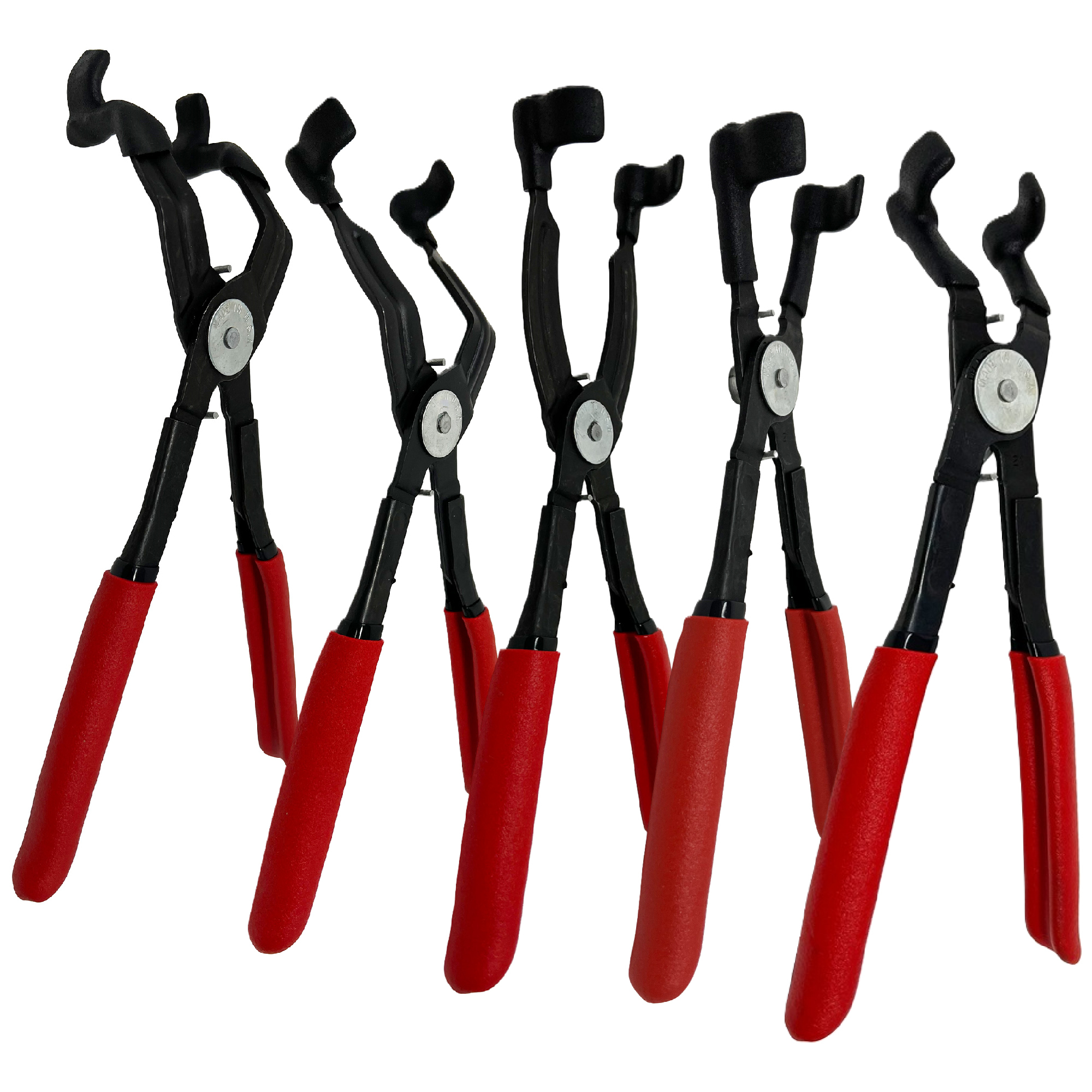

Pressureangle Posted June 9 Posted June 9 (edited) 2 hours ago, JGP said: I tried another magnet. No dice. I tried to spin it by hand, as you can get a bit of a grip on the end of it, it will not turn by hand. If I can't turn it by hand, I doubt a magnet will work, at least not a magnet that I have access to. I can always get it from the other side, by tapping the clutch rod back toward the transmission, but I was hoping to be able to extract it from the slave side without splitting the motor from the transmission. Open to any and all ideas. How much sticks out? How about spark plug boot pliers, or similar? https://www.magnetics.com/products/spark-plug-boot-pliers Edited June 9 by Pressureangle 1
JGP Posted June 9 Posted June 9 30 minutes ago, Pressureangle said: How much sticks out? How about spark plug boot pliers, or similar? https://www.magnetics.com/products/spark-plug-boot-pliers Great idea. I have never seen those before. 1
