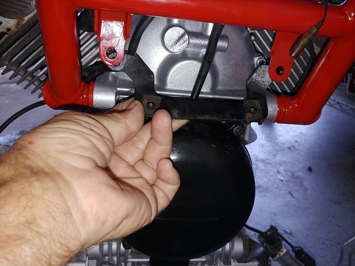

skibum69 Posted Monday at 02:08 PM Posted Monday at 02:08 PM Can someone take a photo and show me where the regulator/rectifier and alternator are on the V11 Sport Naked? Thanks
docc Posted Monday at 02:16 PM Posted Monday at 02:16 PM Alternator is under the round cover on the front of the motor. (Yours is likely silver and not so beat up as mine looks . . . ): Looks like this under the cover (potential wire attachment failure circled): Regulator is the finned, rectangular silver box "usually" mounted below the oil cooler between the horns: 1

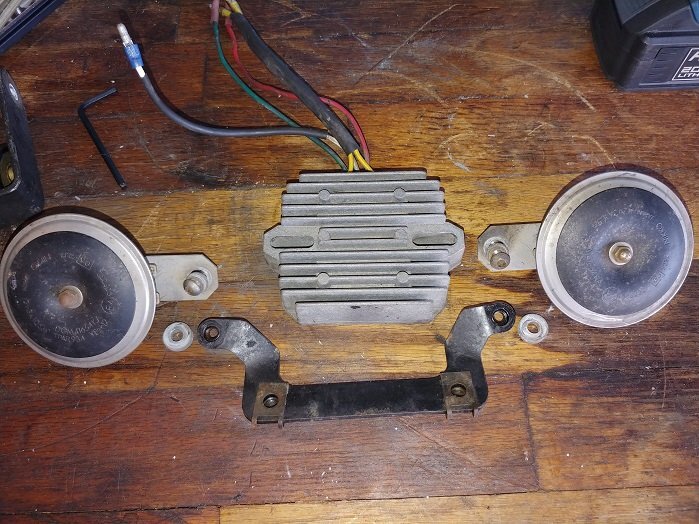

Pressureangle Posted Monday at 03:56 PM Posted Monday at 03:56 PM Happens mine is on the bench waiting for new regulator to come. First is assembly, bracket horns regulator Second is bracket placement on frame. Hard to see behind mounted oil cooler. 2
