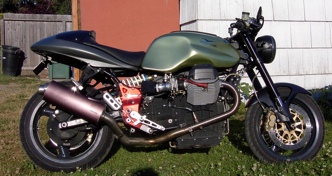

dlaing Posted August 1, 2006 Author Report Share Posted August 1, 2006 Got rid of the dip at 4 & 1/2 didn't it If there is a Gallery it would be worth touching Mark up for a copy of the Dyno run they did on the 'Tetanus' an old Ambo he pulled out of some bush somewhere and took along to some big Harley Dyno-Drag. He simply swapped the oil changed the fuel and stuck a battery in it and it made a whopping 27BHP, (Or some other paltry amount.) and nearly gassed everyone on the SanFernando valley with it's stink but it still got the biggest ovation of the day Pete I could not find the dyno for it, but here's some pics http://www.motoguzziclassics.com/MGCTetnus.asp Can't believe they bothered dynoing it Martin Barrett's bike is a similar risk for tetanus http://img.photobucket.com/albums/v93/mgbl...i/050506004.jpg but atleast it makes more than 27HP.... Link to comment Share on other sites More sharing options...

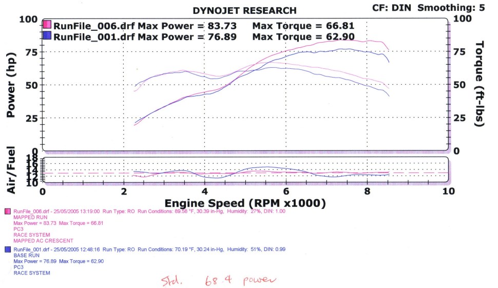

Baldini Posted August 1, 2006 Report Share Posted August 1, 2006 Good idea to put up dyno sheets in one place Dave - praps it could be FAQ'd? This is mine: 02 Scura with MG Ti cans/ECU kit, Stucchi xover, drilled airbox lid, K&N filter, PC111. Tappets, TB/TPS etc set correct then blue is before, red is after tweaking PC111 on dyno. KB Link to comment Share on other sites More sharing options...
