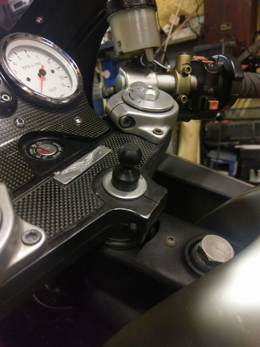

 I can not find this mount.  The diameter of the steering tube is just 8 mm.  Most of the mounts from ultimate addons are >12 mm.  There is no thread for a bold.  Where can I find this kind of mount.  Thanks Marc

dowieze, This is what I used instead of the mount you are trying to find. There is enough room to put a nut on the bolt inside the steering head itself. A smaller socket set with plenty of extensions and a long reach/deep socket will get the job done. Using a shorter bolt would have been much easier, I used the shortest of the 3 supplied.
RAM Motorcycle Handlebar Clamp Base (RAM-B-367U)

Thanks for the information.  Just unscrew  the nut of the steering head and place a nut on the inside.  Cleaver.  Best regards. Marc
