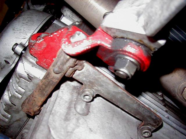

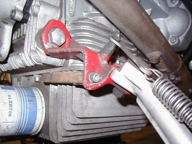

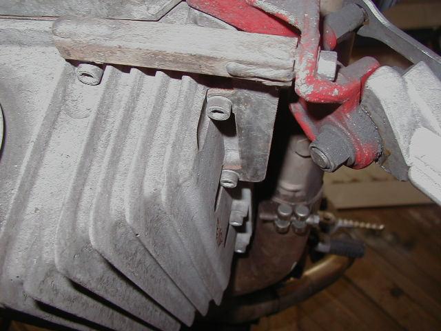

Deep_V_bracket_01.jpgDeep_V_bracket_03.jpgDeep_V_bracket_02.jpgIt has been over three years since I installed the deep V sump on my 2000 V11 Sport, but if my memory serves me correctly there are only a few items needed in installing the sump.
The sump I have does not have the site glass. I am not sure if the newer ones do or not.
As far as I know, there are no dealers in the U.S. that carries the sump. MG Cycles does have them but they get them through Stein-Dainse? so the price is higher since it has to go through two distributors. I think Raceco in the UK had them for cheaper but then you have to pay the shipping etc.
The sump comes with longer bolts needed for the sump and it comes with a length of hose and banjo fittings that attach to the frame oil catch (drainback hose to sump). The oil pickup is casted into the lowest part of the deep V sump.
You will need the proper oil filter (stock guzzi filter) and a sump gasket. The sump gasket you will need fits between the upper stock oil pan and engine block. Yes, the stock V11 oil pan is two piece.
Also, there is a weird tube and oil cooler thermostat that is removed with the upper oil sump, the stock oil filter center needs to be removed and installed on the new sump. The oil bypass valve also needs to be removed and install as well. This valve is super tight (lock tighted inplace) and I ended up cracking the housing to the thermostat housing upon removal. Just a warning.
With the deep V sump, the amount of oil the sump holds is about the same as the stock V11 sump. If the sump were going on an older model than, yes, the sump has a larger capacity.
I had to make up the mount to help support the sidestand. The itty bitty 6mm bolt really does hold the sidestand in place. I never got around to painting it, so it looks kind of sh&()^$ty.
Mike
43395[/snapback]
About the question of side stand i replace the oem system by one coming from first daytona or first sport carb so the stand is now nearest of the engine and it is a better looking system :P
Have a look on the supertwin
