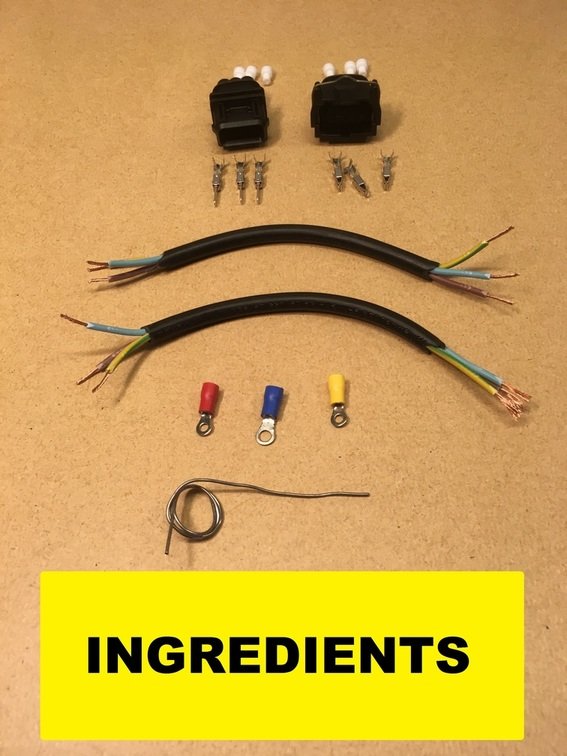

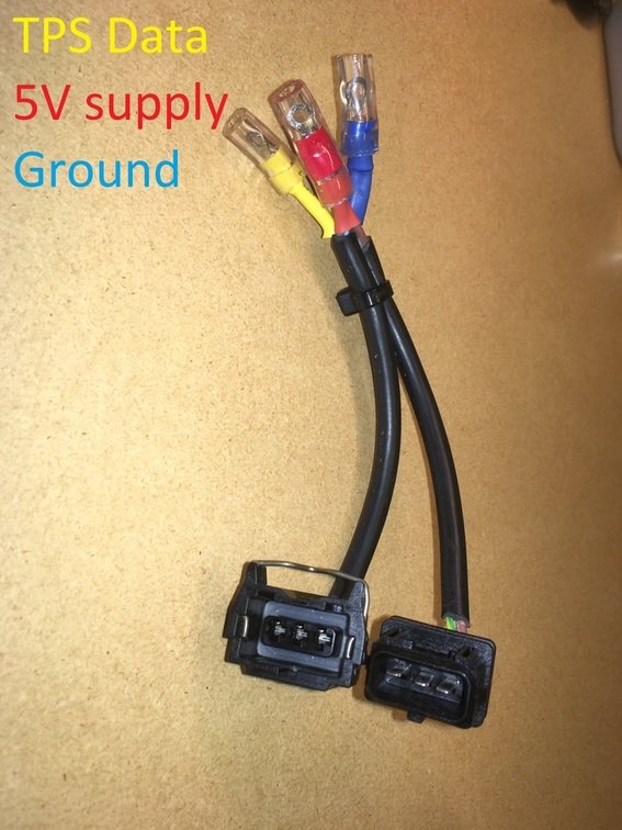

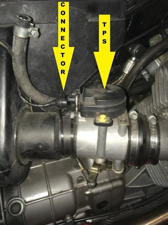

Owing a MG V10 Centauro, Ive made a TPS-harness myself, I used Superseal 3 pin male and Female, see link: https://www.dkvolt.dk/produkt/superseal-stik-3-pin-er-et-vandtaet-stik-til-samling-af-ledninger/ Which fitted the OEM connectors 100 %. See photos. Greetings from DK Niels Knudsen.
