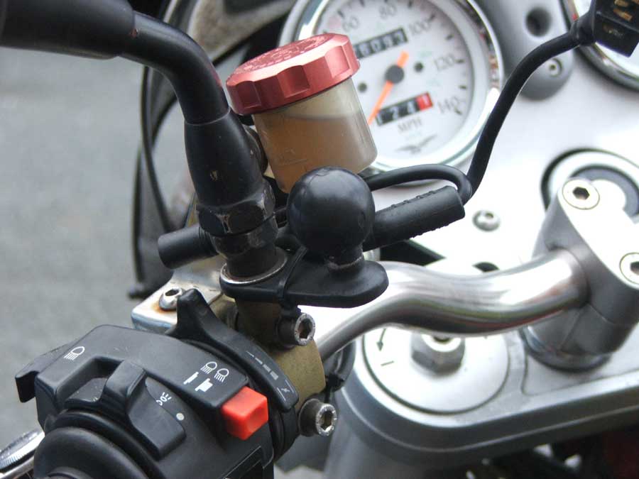

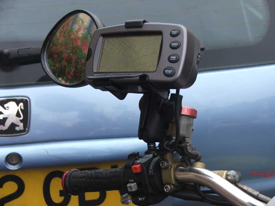

Hi I use a Garmin 2610, and although I have changed bars the mounting would work with original bars I think. All the parts are available from RAM. Hope this helps Gary
