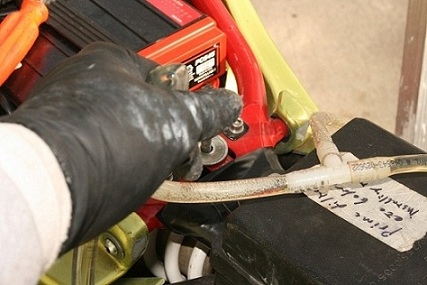

  6. We sometimes need to work on our bikes with the tank removed. With gravity feed to carbs this is easy, but harder with fuel injection which must recirculate fuel through a back pressure regulator to maintain pressure at the injectors. Here’s my solution: Drill a hole near the bottom of a small metal can and solder in a half inch brass hose barb fitting. I used a gallon Coleman fuel can because the weight and size make it balance better and the handy bale makes it easy to hang above the bike; but a smaller can would work fine. Connect this fitting with vinyl tube to a half inch barb T and run two tubes to a half inch nylon double barb and a half inch-quarter inch double barb. These connect to the fuel pump inlet and the regulator inlet hoses respectively. Suspend the tank and let the lines fill, then restrict the regulator side with a clamp or simply hold the tube folded as shown in the pics. The engine will start, run, and rev normally and you can see the return flow bubble past your restrictor. Tighten all hose clamps, especially on the regulator side as pressure is considerable and a blown fitting will shoot a nice geyser of gas around your shop (big fun). I wired the barbs for the same reason. This rig is a big help for jobs that would be impossible with the tank in place, and it is dirt cheap. Winter fun…. Motopierre

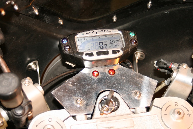

  7. Here are some pics of my vapor installation. Hope they upload OK. December Cycle World review of new Hyde Harrier (Hinkley Bonneville in replica Rob North frame, tasty !)shows Hyde using the Vapor for instruments, so perhaps I was hasty. Finally got under the tank and re-routed wires. Tach pickup closer to coil with less than .75 in. in contact with plug wire seems to be much steadier. Need to ride it for final assessment. Temp pickup is ID 14 mm to fit around spark plug. No way to fit it on the valve cover. I'll know soon if my bodge on the bottom fin works or not. While I was in there I covered the fuel pump with .75 in. synthetic foam rubber insulation topped with aluminum foil tape. Hope that ends the dread vapor lock that has occurred just often enough to be a real pain. Thanks for everyone's replies.
  8. I have installed the Trailtech Vapor on my 2000 V-11 Sport because the speedo was grossly inaccurate and the tach never worked. Pics to follow. This is a different unit from the one pictured that has tach function too. Some comments: Speedo is correct if you measure and enter the correct wheel diameter. Tidy installation of speedo sensor on fork leg is difficult. It will work but looks ugly and added-on. Tach signal is jumpy, an approximation at best. I got some feedback from Trailtech, but have not yet found the right solution to eliminate the tach jumping at least 1000 rpm around the true reading. They are really responsive to customer questions, but the inductive pickup seems to be hyper sensitive. Naturally this imprecision makes the shift light function totally useless. Wiring is straightforward if you know your wiring harness, but the supplied wires are really thin. I made a dedicated ground on one valve cover screw to be sure everything worked. The supplied indicator light holders will take the stock Guzzi lights if you wrap them with one or two layers of electric tape. I needed 2 extra lights to use all six Guzzi indicators, but I fitted them into the bracket I made. The engine temp sensor is designed for water cooled bikes and over-ranges at 400 F, so it is useless on an air-cooled bike when the sending unit is mounted under the plug as Trailtech suggests. I wired mine to a spot on the lowest fin of the left cylinder. It might work there but will not provide very useful information. The Trailtech unit is smaller than it looks on their web site, but the display is bright and easy to read, so the size is not a problem. In summary, The Vapor Trailtech is a good try, but not sufficiently well-developed to make a good substitute for the crappy stock Guzzi instruments. There is a German company that makes really nice looking alternative isntruments with the same functions, but they are very very expensive. I'll try to relocate their site for my next post with pictures of the Vapor
  9. When I first tried running my 2000 V11 engine with the tank off I quickly found that the aux tank I made would not work because it did not provide any back pressure the way the in-tank regulator does. What I did was crude, but it worked. I simply squeezed the return line enough so the engine would run above idle, but of course I then didn't have my hands free. Eventually I will make some kind of adjustable flow restrictor. I just made the tank by soldering a brass fitting into the side, near the botton of an old Coleman fuel can. Then I used nylon T connectors to take one clear vinyl line to the fuel line on the bike and another to the line to the regulator. If all the connections are wired or hose clamped they won't pop off with back pressure. Just compress the return line from the regulator with a small C-clamp or similar device. Could luck.
