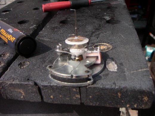

picture of problem part. the coil is visible, the thin wires not but they are easlily broken by movement of the needle. Stupid thing is, on assembly I set the needle perfectly in zero, now it is again a little off set already.. maybe I should have set it below zero without power connected..

Fixed the tacho, had to cut it open. Hubert you were right it is magnetic. And spent an hour cleaning it after. Problem was the same as the one mentioned in the thread (with the alu-tape). At first I was disappointed because it looked okay. Later I notced the hair thin wire from the small coil to the rotor (one of the two) was indeed loose although it looked OK. Was able to solder it however. And working! Saved me 275 Euro for new instrument or 175 for replacement on exchange basis that is of course if it is not in two halves yet.. Regret to inform you I did again the duct tape fix to connect the upper and lower part of casing... bad habit but works for sure. Fixed the stalling of hot engine. This was caused by completely off tappet clearances (way too narrow). Thats what you you get if you buy second hand bikes.. So it makes me more or less happy now.. Johan
