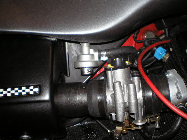

Have been doing a little more investigating since my last post. I found a fairly clear picture of the regulator in a maintenance manual that shows this vent uncapped. I guess the regulator is working from atmospheric pressure after all. I also looked for the ports on my throttle bodies to hook this up to and could find none. There are some bosses cast into them that looked like they could be tapped for this purpose, but they are unused on mine. My fuel line routing is also different from the diagram that Ryland refers to in his reply. My system has a single line that goes from the tank to the pump, then the filter, then the left throttle body, then the right throttle body, then the regulator which ofcourse goes back into the tank. After finding the picture I referred to and reading the last comment, I feel sure that this regulator port is as it should be. The bike seems to run OK so I am going to leave it be unless I find some other reason to think that this configuration is incorrect. Thanks for your comments and advice. Tomcat
Thanks for the info. I'm going to try to hook it up and see what happens. It looks like someone has done away with the whole evaporative emissions system on this bike so I assume they figured they didn't need this hooked up for the bike to run well. We'll see what happens when I ride it with this connected. Hopefully tomorrow if the rain lets up. I'll post the results. Thanks again, Tomcat
I just got this bike last week so I am still learning how everything works. From what I have read, this is the fuel pressure regulator. I see it has a fuel hose coming to it and one going back to the tank but can't find a diagram or picture that shows what the uncapped port is supposed to be connected to. I am assuming it should be hooked to a vacuum source to sense fuel requirements but that is just a guess at this point. Can anyone identify this connection for me. Thankyou. Tomcat
