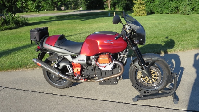

  2. Very good condition. 17,000 miles. Mistral mufflers and crossover. Power Commander. Stock airbox. Stucchi rack. Very well maintained in the 7 years that I've owned it. New Michelin Pilot Road 4 tires 1,500miles ago. Recent fluid changes to final drive, transmission, brakes and clutch. Includes front and rear stands, chock, uninstalled Roper plate, Carbtune (to balance throttle bodies), and Odyssey battery charger. Also stock exhaust parts. Illness forces sale. $4,500/offers. Located in Adrian, MI I wasn't able to post most photos here because of file size, even when reduced. I will email more to interested parties. PM me. rwake
