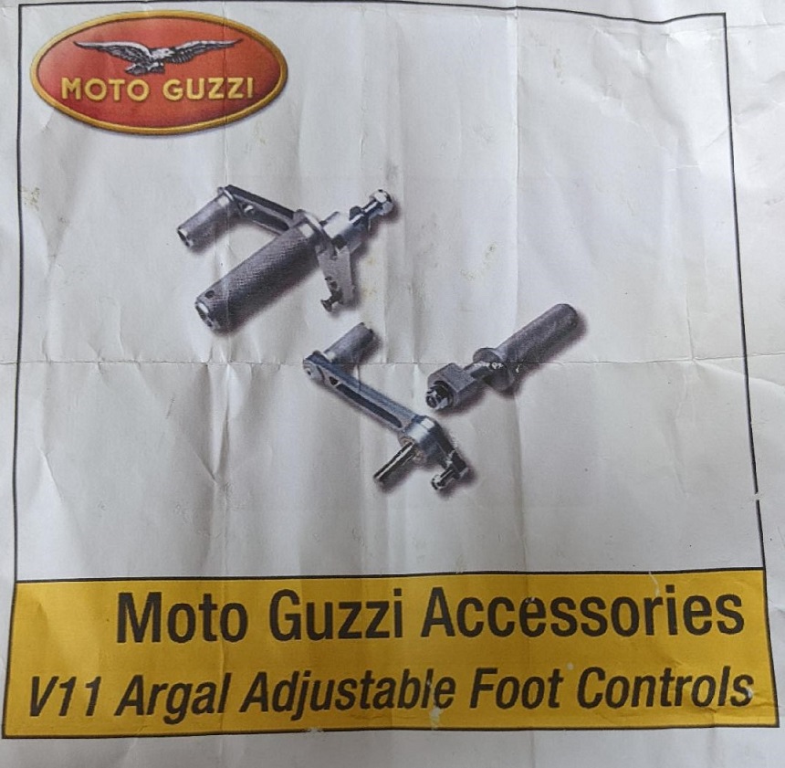

Hello folks, I think, I cracked the case. Once I have installed and test driven I will post pics. The installation is a mix of provided parts and old linkages of the original shifter. After install and test drive. Shifting is firm but not better. Lowering range is low, 1cm, so not a great kit for lowering your peg. Pics see attachments for fit and finish.
This ARGAL adjustable foot control set came with the bike when I bought it. Has anybody installed this kit for adjustable foot controls on their V11 Cafe Sport or similar? I can't figure out how this kit fits my bike? See this picture as to how the kit looks like! Please post some pictures if you have an installed kit on your bike! Thanks a bunch!
