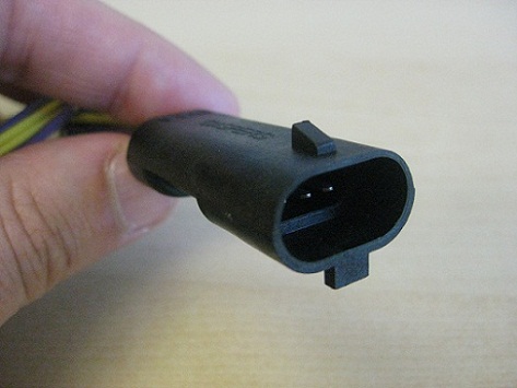

Hey All, I found a company called Caspers Electronics in Colorado that made me an inline TPS breakout harness with colors to match the Guzzi harness for $20! This harness uses one Delphi Metripack 3 wire female connector and one male mating connector of Caspers' own design (which Delphi never offered). Caspers sells the mating connector alone here: http://www.casperselectronics.com/cart/index.php?route=product/product&path=9_60&product_id=561 I know you can just back-probe the connector to measure the TPS voltage. That is what I have done in the past, but I wanted something a little more secure that I could leave connected during a ride to try out some slight adjustments on the road. The guy I dealt with was Dennis (dennis@casperselectronics.com). He finished the harness within a few hours of my request and shipped it the next day. If anyone else wants one of these, here is what I asked for: "I am looking for a TPS breakout harness that is similar in concept to your part #108106, but uses the Metripack 150.2 pull to seat 3 way connector (the oval shaped one w/ the green seal, not the round one) and your mating connector (part # 410016). Can you give me a price for a harness like this?" (the price was $19.95) These are the wire colors of the Guzzi harness: A - Violet B - Yellow C - Black/Violet I didn't specify any wire lengths and he gave me about 20" of unterminated wire for the breakout part and about 2-3" between the connectors. I terminated the breakout wires myself with some 2mm sockets for my multimeter leads. Edit: This harness is now a stocked part (#109172) at Caspers. http://www.casperselectronics.com/cart/index.php?route=product/product&product_id=853 Dan
