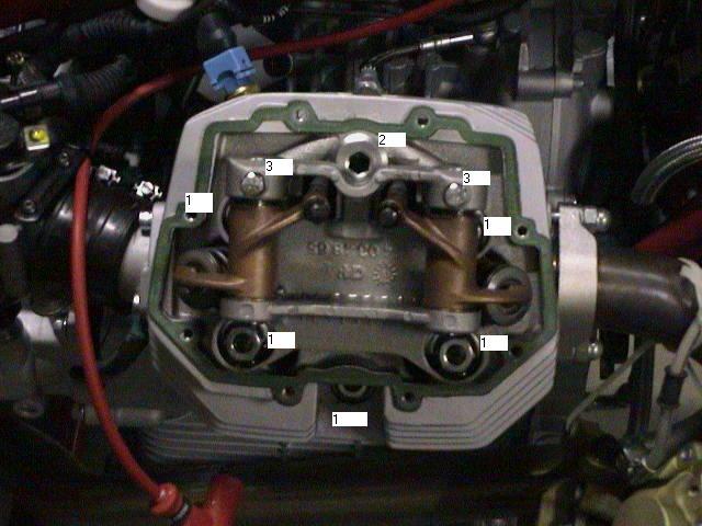

Remove the spark plugs and valve covers (8 X 6mm bolts with 5mm allen heads). The valve covers may require a light tap with the palm of your hand to pop loose. You will then see a nice, simple OHV pushrod valve train. Note the numbers on the image below. The items marked "1" are the five 17mm head nuts; note that two are almost completely obscured by the rocker arms. That is why the rocker arms must be removed before the head can be re-torqued. The single item marked "2" is the cover for the sixth bolt. Both the cover and the sixth head bolt are 10mm allens. The two bolts marked "3" are 5mm with a 10mm hex head. They hold the pivot shafts for the rocker arms in place.

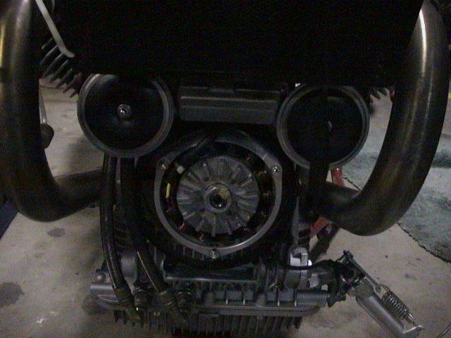

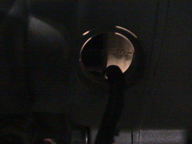

Find TDC for the cylinder. First, remove the black rubber plug over the flywheel. The plug is behind the right cylinder and directly below the right throttle body. Once the plug is removed you will need to find Top Dead Center (TDC) for each cylinder BEFORE you begin working on that cylinder. This is where the light will come in handy; shine it in the inspection hole while turning the crankshaft. In the graphic below the left cylinder (indicated by the "S") is at TDC. For the right cylinder a "D" indicates TDC.
You can spin the engine by putting the bike in a high gear and turning the back wheel or by taking off the alternator cover and using the 24mm nut to spin the crankshaft.

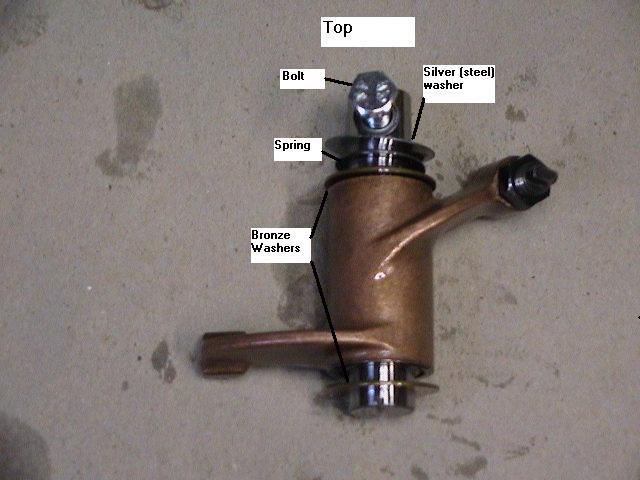

Remove the two bolts (marked "3" in the first graphic) holding the rocker arms in place. Very carefully slide the pivot shafts out of the head. Note the rockers and the washers and springs SHOULD stay in place but may not; be careful. With the pin completely removed slide the rocker arm and the washers and springs out. Again, there is a small amount of spring pressure, don't let any parts get loose. Carefully note the orientation of the parts. Reassemble the rocker arm, washers and springs, exactly as they came apart, onto the pivot shaft. Put the rocker assembly aside in a clean, safe place. Repeat on the other rocker arm. Finally, use the 10mm allen tool to remove the plug over the 10mm allen head bolt, this is marked "2" in the first graphic.
I would advise you to only disassemble one cylinder at a time. This makes it easier to keep the parts organized and gives you a reference in case you have a problem. The order of assembly for the rocker arm shaft in the "square fin" Guzzis engine should be (from top where the retaining bolt is found) silver (steel) washer, spring, bronze washer, rocker arm, and bronze washer. Note that this is a good time to replace the rubber O-ring under the plug (item "2" in the first graphic) hiding the sixth head bolt. I understand it is a pretty generic part, anybody have a part number or description I could give my local parts house to get a bag?

The best way to reassemble the rocker arms by sliding the pivot shaft into place from the top. Place the washers and spring on the shaft. Being sure the washers and spring are still on the shaft push them (and the shaft) back to provide room to slide the rocker arm in place. Finally push all the parts (washers, spring and rocker arm) up enough to slip the final washer into place. However, if you have not removed the fuel tank this is not possible. If you are willing to be very careful and patient you can reassemble the rockers with the tank in place. I have found the best way to replace the rockers with the tank in place is to make a "sandwich" with the spring and the two washers. I do this by putting the three parts on the shaft below the lower mount and squeezing them together. Without letting the spring expand put the "sandwich" in place above the rocker arm and slide the pivot shaft into the top mount.

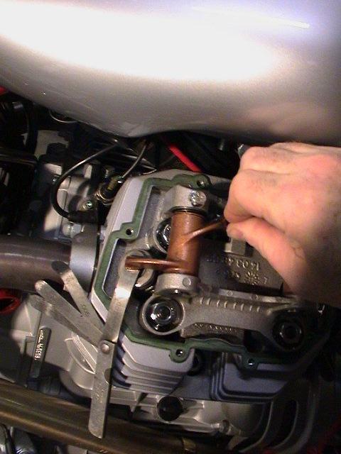

Next, check/ re-set the valve clearance. Since the cylinder is already on TDC you simply need to use the feeler gauge to check the clearance and, if necessary, adjust the screw and lock nut on the pushrod end of the rocker arm. The lock nut is a standard 11mm; the adjuster is an odd shape. The best tool I've found is a 4mm wrench from my ignition wrench set. There may be a special tool to hold it but I am not aware of it. As with any pushrod engine, a little pressure on the pushrod side of the rocker arm (see graphic below) will take up the "slop" in the parts between the camshaft and the rocker resulting in a more accurate setting.
Now, what should the clearance be? This seems to be about like asking for the best beer, lots of opinions. The one thing everyone seems to agree on is that the US setting of 0.002" intake 0.004" (or even 0.002"!) exhaust are too small. On the plus side, the US settings will slightly reduce the clatter from the valves. Personally, I used the "world" settings of .004" (.01mm) intake and .006" (.015) exhaust. Another thing commonly done is to add .002" (i.e. .006" intake and .008" exhaust) to the setting for engines with new head gasket. This is intended to allow for the compression of the new gasket. Also, if you are building a new engine Guzziology has a procedure to compress the head gasket, again worth the price of the book.
