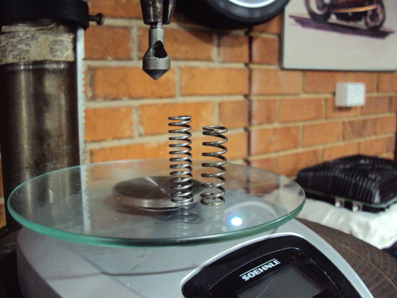

Lucky Phil 5,847 Posted April 13, 2019 Original oil pressure relief valve spring on the left and replacement on the right. Original wont get you past 55psi crack pressure, new spring takes you to the 70psi required.
