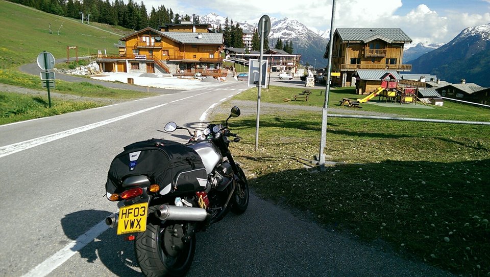

In 2 hours time I am booked on the channel tunnel. It is then down to the Alps, France, Italy and Switzerland and back in 5 days. 2,000 miles in all. Will report back with film from my GoPro. Should be epic.
I'm currently in Courmayeur, Italy after a week of splendid weather in the Maritime Alps however, it all seems ready to go pear shaped tomorrow with an 80% chance of rain.
Hopefully, I won't get rained on all day!

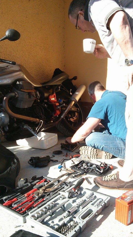

Day 2 - the pawl spring snapped late afternoon (second time in my ownership of this bike).
Day 3 - spent the morning replacing the pawl spring (missed some great riding). Lucky I was carrying a spare (take note all).

The tools were provided by the hotel I was booked in and managed to limp to. Deserves a mention here . . The Belvedere Hotel up in the mountains on Little St Bernard Pass. Biker friendly, decent beer, loads of tools, oils and other fluids plus much needed encouragement and advice. Great mountain views. You can also sit outside with said beer and watch bikers take the challenging corner the hotel sits on and admire the sparks from their side stands.  :thumbsup:
