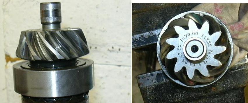

pinion1.JPGjust stripped my bevel and found this :angry:
If your pinion wobbles get it checked !!! :luigi:
Thats an identical failure to mine.....wonder how many more out there?
How you find the play in it? Did you see a slight oil weep or was you checking the drive u/j? Or had you seen the thread earlier and decided to check yours? Have you got parts lined up yet? Good luck.

I noticed the pinion wobble when I greased the shaft joints and as I used to be a car mechanic knew that wasn't right !!
After reading Pete's strip down report I took the box to my local dealer, he said that all V11's had the same play and he could strip and replace the bearings if I really wanted but as I was going to the Trofeo Rosso I decided to leave it until the winter, but after reading your report I decided I'd tackle it myself.I haven't ordered the bearings yet but I have your list to work off so I'm hoping to organise that this week (its going to take me a while to remove the old bearings and find a deep 36mm socket for the pinion nut anyway!!)
