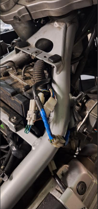

Here's what I'm looking at. The lines with the blue electric tape I've marked as connecting directly to the ignition. I've tried to make that bundle of wires as slack as possible, and it still pops fuses in this state. The connectors look fine as well (no obvious damage)
I am back with an update, in which is this no change. At this point the tank is off (so theoretically no pressure/ pressing on wires) and it still continues to pop the 10A fuse. The issue definitely seems to stem from the connectors underneath the tank near the ABS control unit, but I'll be damned if I know the correct combination to make it work. I did get close where it didn't seem to be popping fuses with the tank on (not bolted in) and was able to turn on the bike with working headlights. But as soon as I bolted it in and went to start the bike the fuse popped (though the ignition was able to turn on without popping) It is a good suggestion to try and trace the wires connecting from the wiring diagram to the bike, and I have done that, but all the wires are bundled up into the harness and I'm not keen on cutting into the wiring harness
