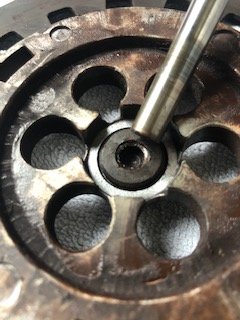

I’m afraid I think i might know what the problem is, i was looking at the pictures, and i saw the friction plate is asymmetrical, so I took a good look at the new (spare) one, and i’m afraid that I placed it the wrong way around, and that the inner side is pushing the pressure plate all the way in

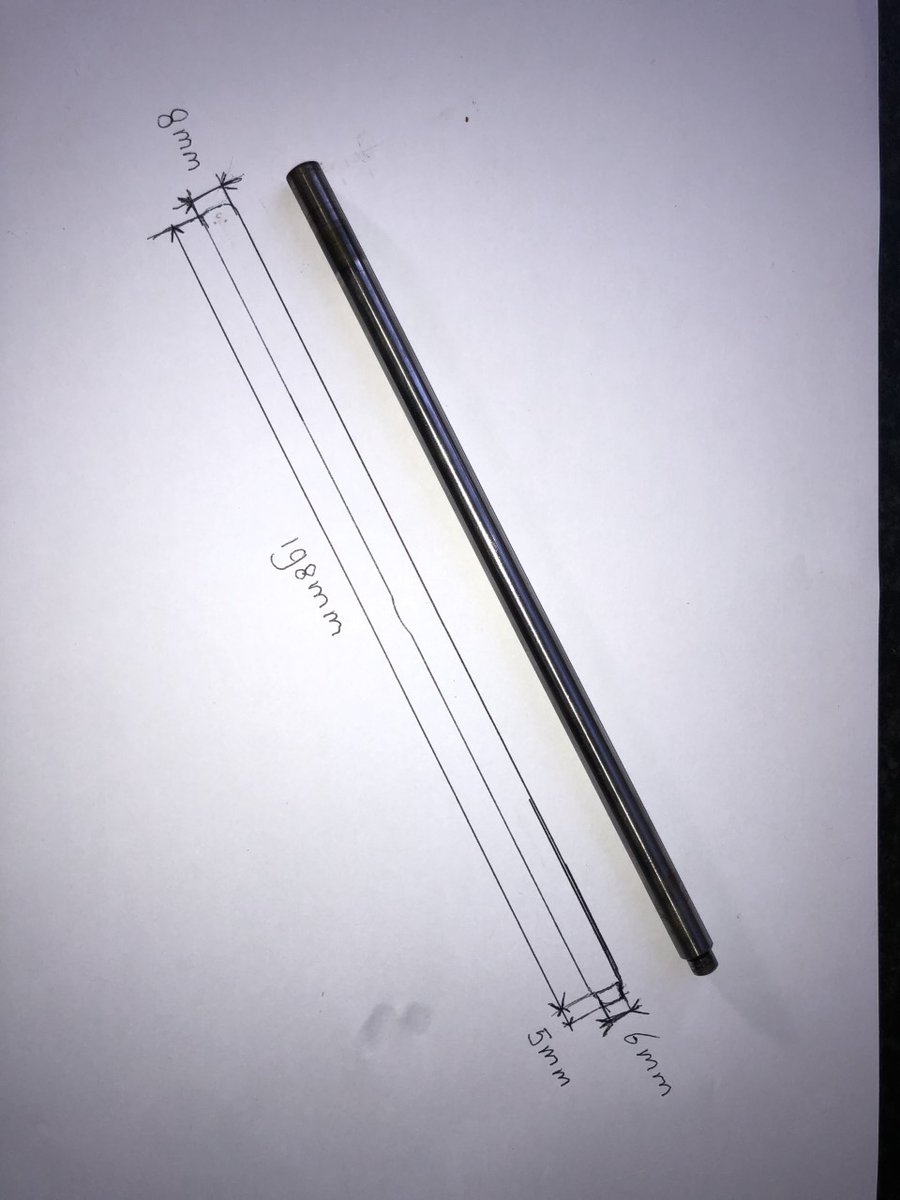

Hello Phil, The problem was that when i opened up the throttle the clutch started slipping, at first i thought the friction plate was worn out, but it seemed okay. I found out, it was a 6 speed RAM clutch, so I ordered a new friction plate. This one was only 0,9 mm thicker then the original one, so i thought this cannot be the problem. After a lot of research i found out that the length of the pushrod was probably the problem. And the pushrod didn’t fit in the pressure plate, so i machined the original pushrod so it would fit in the hol in the pressure plate. But after i reassembled it, de clutch lever feels hard, and it is impossible to pull te lever. The length of the Pushrod is 19,8 mm Kind regards, Jorrit

I have checked the length and it’s the same length as the old one with which it has worked, so unfortunately that’s not the problem😢.
Hello, i had a problem with clutch, it slipped. I took the engine from the gearbox and found out that the pushrod was a little to long/thick at the end. I turned of the end in the lathe. End rebuild the engine. But now it doesn’t disengage. First i thought it was a problem with the slave cilinder, but after i took the entire backend of the bike apart, it all seems to be okay. Then i though that I turned of to much from the pushrod, so i ordered a new one. But I still have the same problem. I can’t pull in the clutch lever. It feels like there’s now pressure plate behind it. if I look trough the gearbox I can see the pressure plate (and it is installed in the wright way). Anybody any idea what is wrong? Kind regards, Jorrit

Some extra info; If i look closely it seems like it was properly installed. but if i look a the clutch, it looks like it should be turned around I have another picture, where you can see the pushrod fits exactly in the spring, but i'm only aloud to upload 200mb

I have found out that i probely have RAM 6 speed clutch. At Stein Dinse i orderd a RAM 6 speed clutchplate (https://www.stein-dinse.biz/product_info.php?products_id=461370), And it looks just like the one that came out of te Scura.But it is only 0.9 mm thicker then the old one New 6,1mm vs old 5,2mm). So i'm afraid that this one only wil last a few 1000km. I also took out the pushrod; I'm wondering or this is the wright one. And whether it was properly installed. The thin side was on the rear, in de slave clutch cilinder. Can anyone tell me or this is the wright pushrod is for the RAM 6 speed clutch? Kind regards, Jorrit

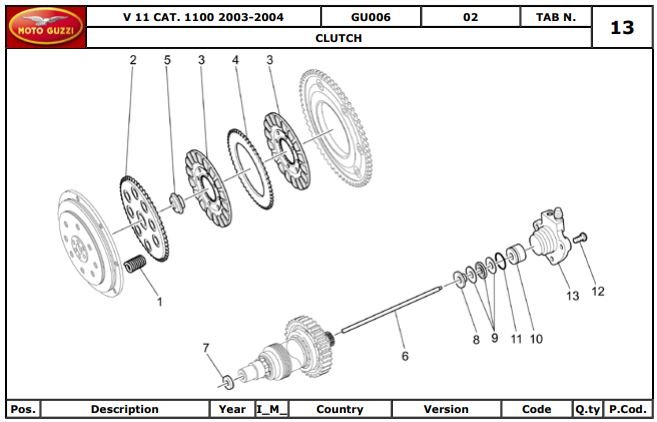

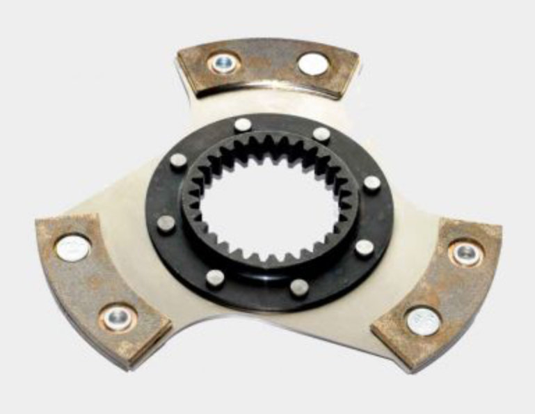

I was wondering what is the different between the clutch disk of a Single clutch plate clutch and the clutch disk of a double clutch plate clutch are they not interchangeable? My clutch looks a lot like the RAM clutch set, but i can not find any specs and i can not find just the clutch disk. I can only find this;

Hello, Ik have a Scura in 2009 they replaced the cluth for a GU01080140, but now my clutch is slipping. I'm trying to find a new Clutch disk GU01084440, but is is not longer availible. I called TLM (the importer in the Netherlands) and they only tell me to replace it for a double plate clutch, and it will set me back 2000,- euro. Now i have heard it is possible te replace de friction pads on te clutch disk, but to do this, i need to know how thick was the clutch plate. Can anyone tell me this? kind regards, Jorrit
