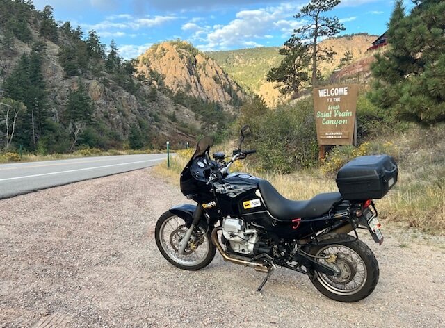

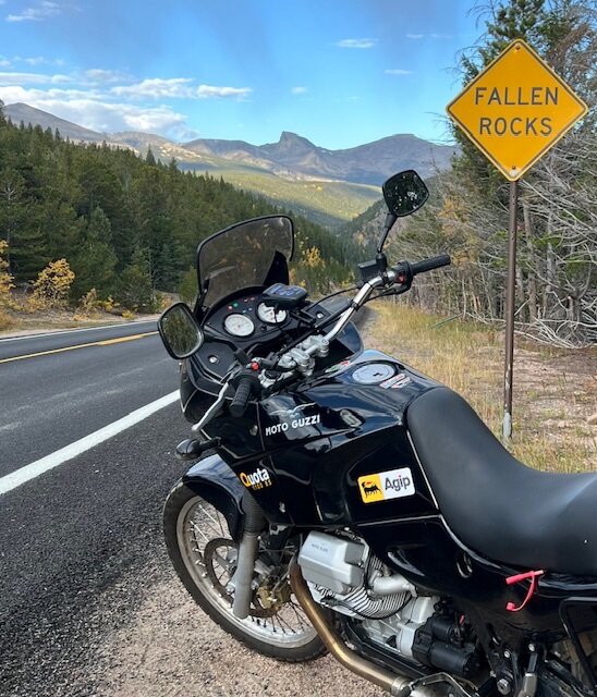

The problems have been fixed! -I replaced the oil pressure switch. -I did a diode test on the regulator - which interestingly had not been suggested in this thread - and the test results indicated that one of the diodes was blown, or was otherwise not working. Discussed the test with Electrosport, and they asked me to send in the unit for further testing. -Rather than wait for the Electrosport people, I bought a new Ducati Energia (OEM) regulator from MG Cycle and installed it yesterday. -Fired up the bike a few hours ago. Oil and battery lamp come on with key on. At idle the battery terminal test at 14vdc +/-, and increase when revved. Went for a 100 mile ride: South St. Vrain Cyn - Peak to Peak Highway - Coal Creek Cyn - Home. Had a blast! Foliage, not much traffic, no battery light at 3-4000rpm, and the bike just roared along. Thanks to everybody on this thread who offered thoughtful troubleshooting suggestions. I really appreciate all of the time and effort many of you have put in trying to help me out. Cheers, Sam
