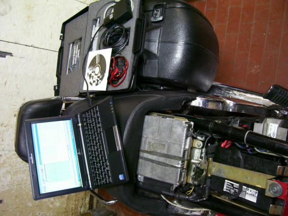

The interface is a cable,one end fitted with a AMP 3 poles connector and a fast connection for the battery poles,this is the ECU side, in the center,sealed,the electronics,i imagine a microprocessor used like a dongle and a few component for translate the voltage level,but i never open,the other end have a 9 poles standard serial connector,i use a 9poles to usb converter..... The sistem work good with a little Eee PC,i put this in the left suitcase and when come back i have my logging. In the picture you see the little black suitcase,inside,visible, the cable and the software CD,the Eee PC is little but friendly object for this use, the box connected is the USB converter + Cliff TTL to RS232 converter,on the bike you see MyEcu fitted in a WM case,not the original!!! I don't destroy the P8 for nothing at world!!This ECU is too rare,in Italy too,is more than a ECU,is very sophisticaded,in the past used on Sierra Cossworth and Lancia Delta Integrale,full capable of diagnostic for every pheriferial..... The question now born....if you like too much the original,why bought MyEcu?...Simple,first i need a second ECU when in the summer i make my journey outside Italy (in the suitcase:1KG oil,throttle and friction wires,tools,tyres repair kit,relais,bulb,now ECU),second MyECU is too cheap,if you want to buy a software for Eprom analisis and programming minimum need 500-800 euros!!(only one ECU) Third,if is possible to make a better feeling with the motor is better in this picture the LC1 cable and pheriferial box,the box is filled whit a special gel i use for submersed electrical junctions,no humidity inside The curious violet and white round object on the right side is an "absolute air filter"(a spare of air compressor i use for homebrewing) fitted on the pressure sensor inlet,before this was connected directly to airbox,but im not satisfied about the continous change of the original WM ECU,after i make this modify this be stable!!

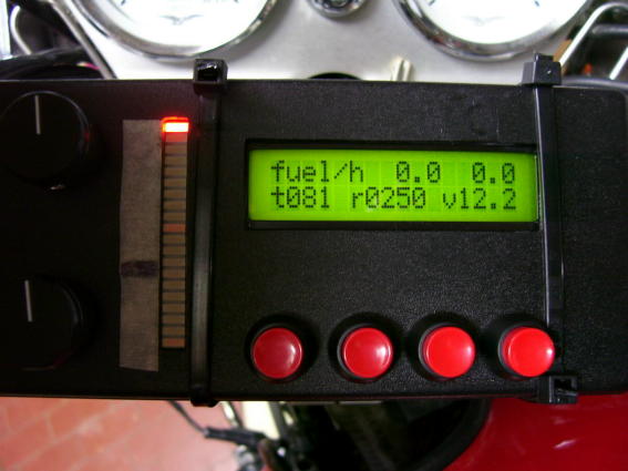

The LC1 is a true good,powerful hardware and software,easy to use,setting,mounting. But the original gauges is too expensive,i made a modify on my optimiser box and circuitry,first a pushbutton with a click feedback,double the third button on the left of the handlebar,change the display with one more great and readable built in a backlight for a night tuning session,i add a simply circuit based on the bottom schematics for read in real time the fast variations of the AFR or LAMBDA output of the LC1.this is more friendly and fast than a number,immediately you understand what happens. The next step is to close the display and bargraph with a sinthaglass,a liquid acrilic glass. Is possible to think to close this in a round gauges from an old bike/car instrument for a permanent installation,for this use you need the power supply on the bottom of the schematics for a good work is better to enclose the diagnostic led of LC1,is not too rare this go on failure state,but if you set a know volt output value for failure state you don't need other led,simply you see only one led of the bargraph fixed,no other work. Be sure to connect ONLY the signal from LC1,the ground is common don't need other connection or maybe you create a dangerous ground loop!!! I used a good microphone shielded cable and waterproof connector from AMP or TICO for external signal wiring and don't have any problem of bad ground connection,only remember to weld the shield only in one side of the connection. I hope my little experience help some guzzi's owner friends.... Kadavere
