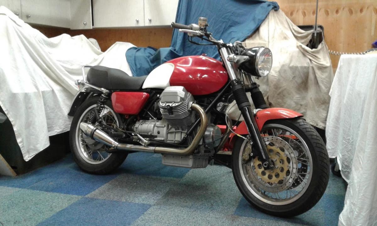

    Hello everybody, I'm afraid I'm a bit of an imposter - I don't own a V11 I do however own a Sport 1100i motor which will ultimately replace the tired 78,000mile motor in this, my LMII: Am I allowed in anyway?
