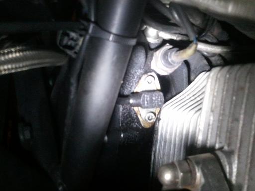

I'm building a list of things I need to work on the 2002 Le Mans. There is something seeping oil in front of the left cylinder. I've downloaded a manual for a V11 sport. I'm not sure it is the same as my bike, but I will ask Moto International when I get there later this week. I think it's the rpm and tdc sensor. First, is that correct? Second, what would cause it to leak? I'm guessing the gasket. It's not leaking oil. There is no oil on the ground. Thanks
