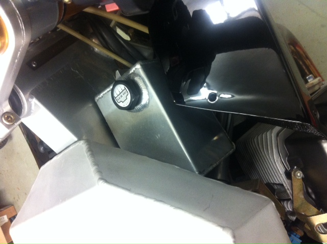

  3. Yes it is the 1064 engine though factory modified slightly, balanced,etc but the same. The oil tank is a small aluminum box mounted on the right side of the frame, high up tucked under the fuel tank. Upper hose goes to frame and lower hose to the front cover. Please bear with me as this is the first MG I have worked on and like all euro bikes they have their quirks. I have looked for these answers but some are illusive. 1) When refilling the sump with fresh oil...do you add any to the oil tank? 2) is it true that you check the oil level with the dipstick screwed all of the way in? P.S. I wish all of the bike manufacturers would just agree if it needs to be seated or screwed in!! 3) Like many dry sump bikes that have been sitting for a long time, the oil tank is empty. Plenty in the crankcase. Should I add oil to the tank before running it? I want it warm to change the oil. 4) On that same subject, if you only fill the crankcase on oil change, how does the tank find its level? Does it just fill itself ? There are no marks on the tank at all. How full does it want to be? 5) Don't want to open a can of worms but I hear horror stories about oil filters coming loose. Some say to use the hose clamp concept, what do you think? P.S. If this is such an issue and could ruin a fancy, expensive motor... Why has nobody made a filter with a safety wire hole in it? Every critical fastener on race bikes are safety wired... Makes 'em safe! And you don't have to worry about them!! As I have said , there is very little literature on this bike so I just want to be thorough. It is a flawless bike with very low miles and I want to take care of it with kidd gloves. Thank you very much!
