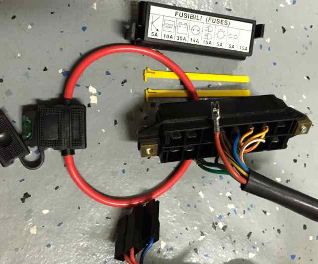

Scud Posted April 8, 2015 Share Posted April 8, 2015 Topic: 30 Amp fuse Purpose: to confirm my understanding, and hopefully clarify for anyone else who might be confused Problem: the stock 30 amp fuse contacts are too small (which causes bad electrical things to happen). Therefore, they should be replaced with a manly-man fuse holder. This is not an additional fuse; it is a replacement. Solution: Remove red wire and pair of green wires that terminate at the 30 amp location in the fuse box (as shown removed in photo). Splice in the manly-man fuse holder and locate it nearby. Question: Is the above correct? Link to comment Share on other sites More sharing options...
docc Posted April 8, 2015 Share Posted April 8, 2015 Aye. Note the lap solder/heat shrink connections. http://www.v11lemans.com/forums/index.php?showtopic=12326&p=148983 ("pre-solve" before bad things happen to good fuses!) 1 Link to comment Share on other sites More sharing options...

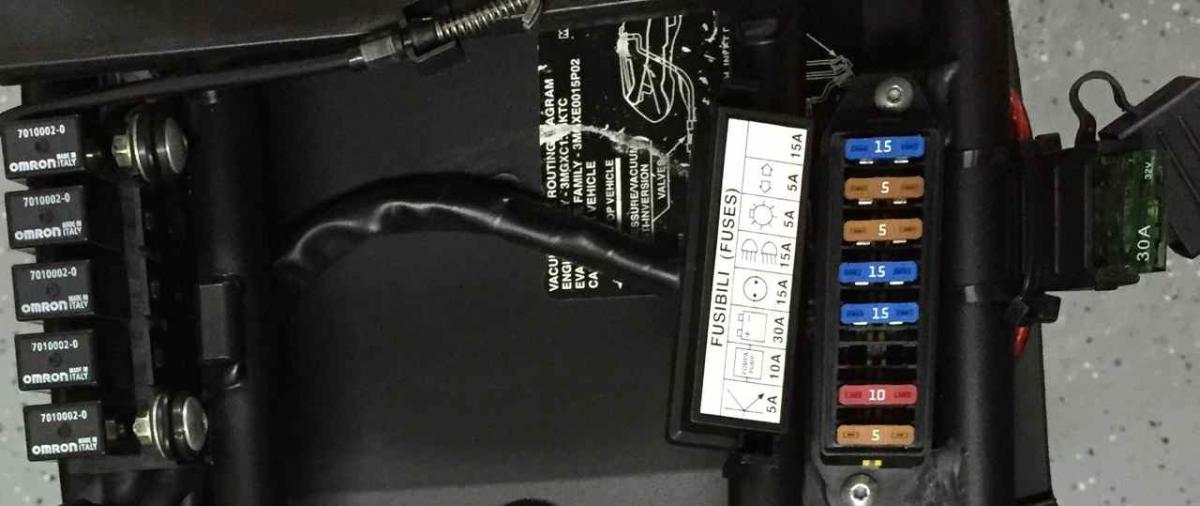

Scud Posted April 13, 2015 Share Posted April 13, 2015 Got the 30 amp Maxi fuse in today - and my fuse box looks like a hockey player's smile (missing tooth). I zipped the Maxi holder to the subframe rail so it can hang out in the large space inside the tail section (like the flasher relay does on the other side.) I noticed that these 30 amp Maxi fuses are rated up to 32 volts - so I guess this is not far off from simply soldering the wires together and bypassing the fuse. @Docc - thanks for the tip on the lap soldering. I also got the good heat shrink tubing with 3:1 shrink ratio and the adhesive. Link to comment Share on other sites More sharing options...
