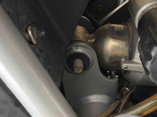

A separate question. On the top of my rear shock is a 10mm long bolt. It secures the top of the shock and has about 15mm of threaded bolt sticking out on the left side but there is no lock nut on it. There are yellow paint marks on the end of the threaded section, so my question is should there be a lock nut or castellated nut on the end of this bolt? Yes,🤔 I think a Nyloc is in order. Can’t do any harm and one less thing to think about while tooling along at speeds close to but not over the posted limit!
A separate question. On the top of my rear shock is a 10mm long bolt. It secures the top of the shock and has about 15mm of threaded bolt sticking out on the left side but there is no lock nut on it. There are yellow paint marks on the end of the threaded section, so my question is should there be a lock nut or castellated nut on the end of this bolt? thanks in advance. M.
