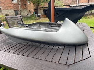

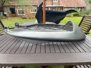

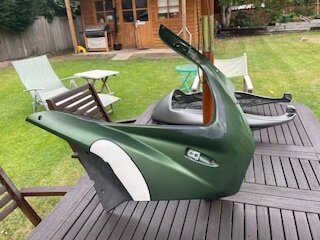

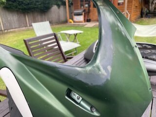

  2. When I recently purchased my 2002 Tenni it was obvious I needed to touch up its paint job. The two areas of most significance was the tail piece and a very poorly right front fairing repair. For the tail I had FMF Coatings scan it and mix up the paint in an aerosol. They were unable to get a good match on the green but I found the Lechler code for it, GUZDS08047 and had Classic Car Paints Direct mix it up in an aerosol as well. Both UK firms by the way. I’m sure many of you are saying paint in an aerosol is no good but I beg to differ. It’s the same paint formula you would get in a tin of paint, it’s guaranteed to have no moisture and they spray nozzles are very good with no air pressure issues (I also paint with conventional spray gun equipment). In the following pictures the tail piece has been painted with the base silver, have the code for it if anyone wants it. Will apply the “Tenni” decals once they arrive from The Images Works decal makers . As these paints are both base coats will spray with matt lacquer top coat once the decals are applied. In thr picture of the right front fairing have removed the poorly applied top coat in preparation of final repair. Will post pictures of final repeats once completed. Interested in your comments as always
