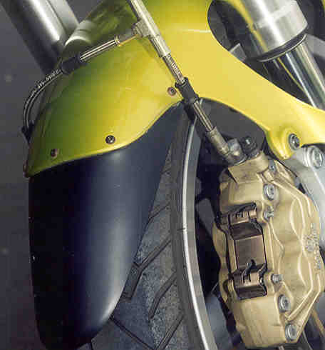

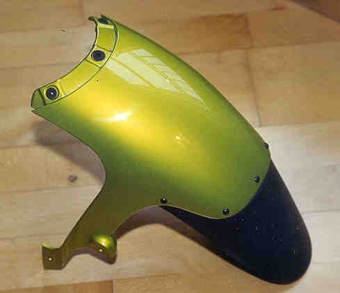

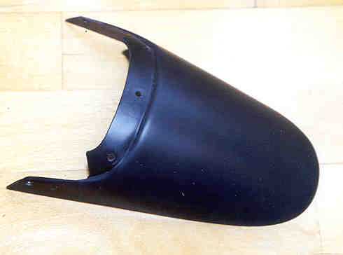

  3. Hello Chris, I did thid mod on my own V11. You need a Kawasaki 500 GPZ extender (94 ->) available at Pyramid Plastics and then just cut and drill it to look like the one on the pic. Fitting is not very easy because as far as remenber, the Kawa fender is more round than the Guzzi but fortunately, the plastic of the extender is quite soft. Cheers
