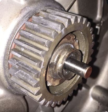

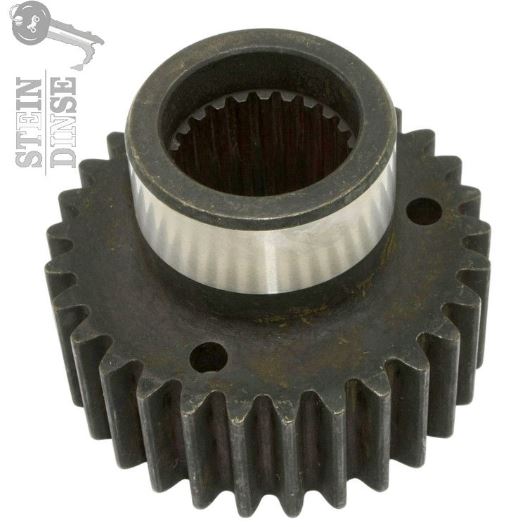

  3. To complete the picture, here's a pic of the hub removed from the Scura's single plate system: This is a pic of the twin disc hub from the internet (which I have mounted into the gearbox): Compared the thickness with the twin plate hub now mounted in my gear box; extra thickness necessary cos of the 2-plate system:

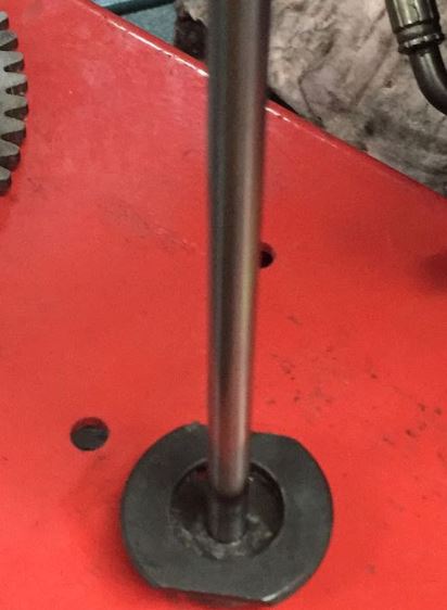

  4. Hi, footgoose, The pic of the pushrod inserted into the bowl / cup is : Seems to be no issue with the fit.

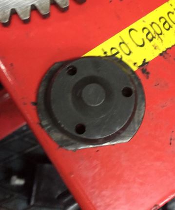

  5. Dear Docc, Yes, the intended replacement is from a single plate clutch system (left) to a twin disc system (right). The parts (actual) can be compared: The pushrod is from the Scura, the hub is from Gutsibits. This is the hub with pushrod installed: This is the bowl or cup that Gutsibits also supplied: The Scura system has a pushrod recess built into the pressure plate. Rather elegant. Reverse of the cup, if that is material.

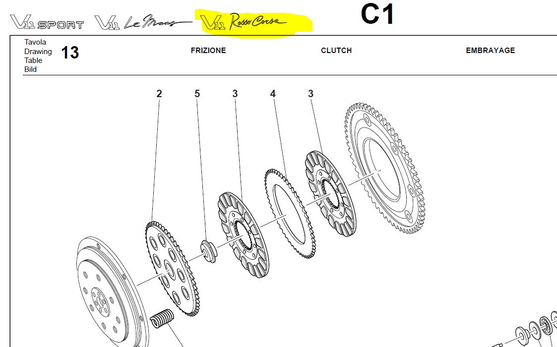

  7. Hi, Docc, I saw that. It did not make sense to me cos the V11Rosso is a twin-plater in the first place? This from the parts catalogue: In any case,it seemed that in that post, the owner reduced the length of the rod than lengthened it. Andy

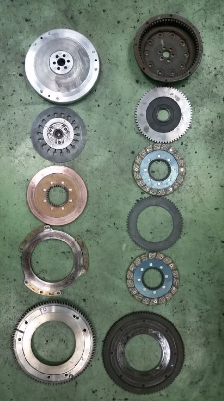

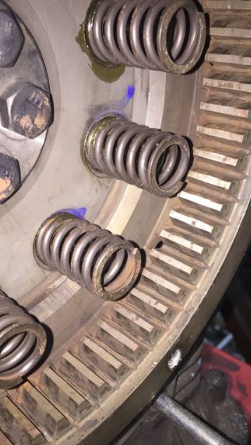

  10. Dear all, I am really at my wits' end here. Removed the gearbox and the springs all seemed to be properly seated. I even replaced the friction plates with the "thinner" 7.5mm ones from MG Cycles, no luck. There is no complete neutral when the clutch lever is pulled in, such that I can rotate the rear wheel freely. Some pics are attached. Can anyone tell if the flywheel is from a 5-speed or 6-speed? Does it even matter? Took out the pushrod to make sure that I am not missing any washers etc. What I will do now is to measure the length of the pushrod actuated extension when the clutch lever is pulled in against the compression of the springs in a vice. This is to see if there is a possibility that the pushrod was not being actuated sufficiently to compress the springs and disengage the friction plates. Am I correct to say that the pushrod is in contact with the pressure plate "bowl" by the fact that there is tension in the clutch lever? Thanks for the views, guys, keep the advice coming. Andy
  11. Thanks for all the views. I just learnt that the donor bike for the clutch was a 99 V11 (in green). I guess I have to tear down and reseat the springs. Is there any sense in alternating the springs? To get that intermediate feel of hard/softness in the clutch pull? andy
  12. Dear Tinus Thank you for chipping in. Yes, the receiver cup is installed; it was omitted from the pic, as were the hubs. I reckon that without the receiver cup, the clutch lever will not even have any tension since the pushrod will not be pushing against it (and the pressure plate/springs)? The unseated spring theory sounds plausible. Something I have to bear in mind but I am really trying to exhaust all options before re-opening the transmission again. I glued all of the springs to the flywheel and then attached the pressure plate. Arguably it could be a dislodgement there. andy
