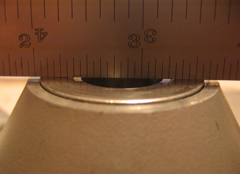

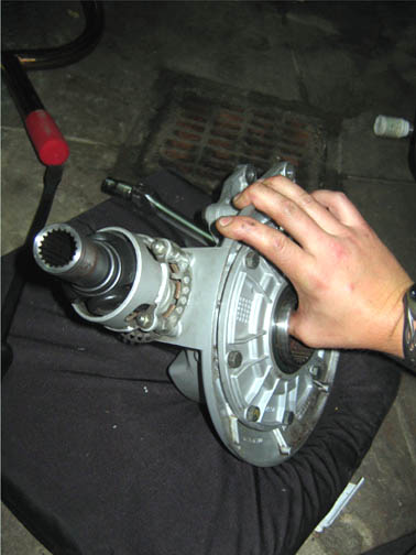

Hi guys, Thanks for your comments. I've been waiting for my shop stand to arrive so I could dig in to this thing again before replying again. I'm including some pictures this time to help describe things. Final Drive The first three show the washer I was asking about. I agree that it only goes on one way, and I can't imagine how one could install it overlapping the race-but it sure seems like that happened at some point. There is even a slight gouge where the washer was installed incorrectly (screwdriver is catching it) My feeling is that the inner race should stick out farther than the washer so that it is compressed along with the other inner races and spacers, and does not rotate. If the washer was wider than the race than it would be clamped tightly between the swingarm and the housing (which must rotate slightly in relation to the swingarm) My worry is that if the spacing on the right side of the ring gear is too short than this would allow the compression of the axle nut to change the preload of the ring and pinion. If I spin the input shaft while trying to push the ring gear to the right (pushing on its L/S bearing race-see photo) I can feel the notchiness I was feeling before. If I then spin the input shaft while pushing the needle bearing race to the left side everything feels good. Wheel Bearings The test I described before (using an axle, spacers and nut to compress the wheel bearing inner races and spacer) Is somewhat standard practice when seting up BMW wheel bearings, and will usually allow you to feel any bearing strangeness. I believe my mechanic was using a front axle which is a bit shorter, but I don't quite remember I also cant feel anything abnormal when rotating the bearing races by hand now that the wheel is off. I think if the wheel bearings were causing this notchiness I should be able to feel something by hand. The spacer inside the wheel feels pretty snug against the inner faces of the bearings. I can slide it up and down a bit if I try, but it is certainly not rattling around in there. Is it possible to remove one of these bearings to measure this spacer against your guidelines without damaging the bearing?
