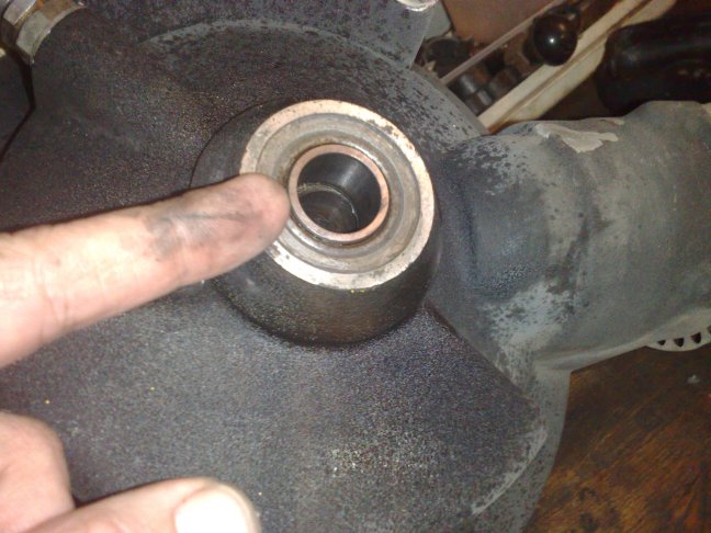

hey nice one guys good news is got it all apart and evrything (except the bearing you guessed at) looks fine. splines, my biggest worry, look good as new, no sign of wear that my aging eyes can see. All other bearings look and feel good too. So a few questions; a) am i right that to get this bearing out i have to diassemble the whole box? not beyond me but i dont have the special tools and would prefer to trust the reshimming and re ass to someone with the set up, doing it regularly see photo; im pointing at the culprit; should there be any type of shim or seal outboard of thisbetween the box and swingarm?? The housing kind of looks like it would take a shim or seal but nothing there... c)pheeeeewh d)id be a (bigger) top of penis :-) not to replace all bearings, seals and gaskets while we are in there and after almost 50k kms woudlnt i. Yes you would. Uou are a top of penis :-) despite this. nigev11
