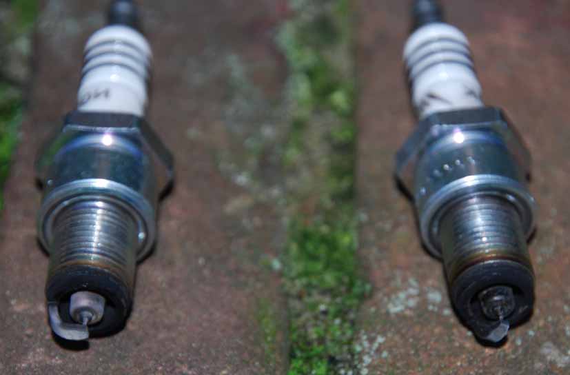

  2. Hi, I took my exhausts off today and noticed that the right header was sort of white inside, while the lift one was black. I checked the spark plugs, and they gave the same black resp. white colour. Coud this indicate the cause of engine vibrations? (I cracked a header earlier this year; the engine vibrates a bit too much @ 3500 and 5000 rpm, while 4500 is OK) The balance seems ok, when testing and setting with a carbtune. What is the good colour? My guess is the lighter coloured right one. But how can the left one turn black? Oil consumption? Bad injector?

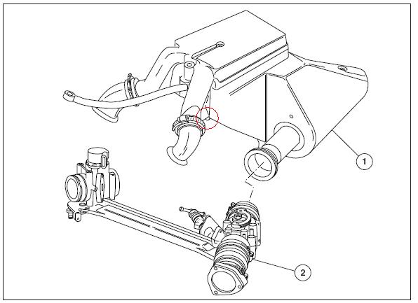

  5. when changing my air filter and fuel filter I found two 'plugs' on the bottom of the tank that where not connected to anything. I suppose they are to let in air to keep the tank from getting vacuum. The workshop manual says "disconnect breatherpipe from coupling E" (see picture), but as I said, there is no pipe. Question(s): Is the pipe required? Where should it lead to? (I did find a possible connection at the bottom of the air filter box)
