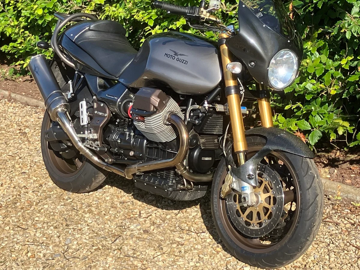

  15. 03 Cafe sport in Northern Ireland
  16. Hi all, it's been a long time but another V11 is back in the garage, technically belongs to my dad but it's in my garage, 2003 V11 Cafe sport with the Moto Guzzi Accessori exhausts and matching ecu, 12000 miles on it and very clean. However want to freshen up a few bolts. Does anyone know the part number for the caliper bolts as they are a bit rusty on it. Thanks
