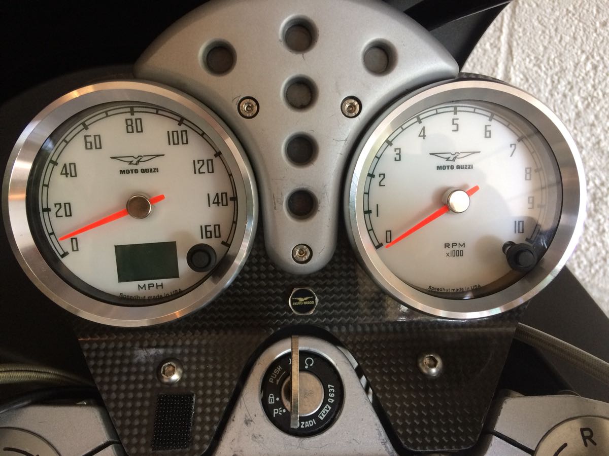

Creativity was lacking in the mounting system. The unused metal area serving no purpose is unsightly.
Fourteen pages of stuff to digest takes a while so take your time. Seems the Veglia gauges can be sold in a snap. Palo Alto Speedometer bought my speedo but the tach broke and my repair botched rendering it junk. I happened across this indicating a different approach: https://www.ebay.com/itm/Moto-Guzzi-V11-Sport-Custom-Aluminum-Gauge-Cluster-with-Koso-RX2N-Gauge-/162841932309
PS, I lucked out with the indexing of the threads to have the pulse generator wires pointing in.
Pulse generator fitting. 7/8” hex. The Dakota Digital device has a 5/8x18 thread. The gear drive nipple that previously mounted the 60 degree cable drive has a 16mmx1.0 thread.

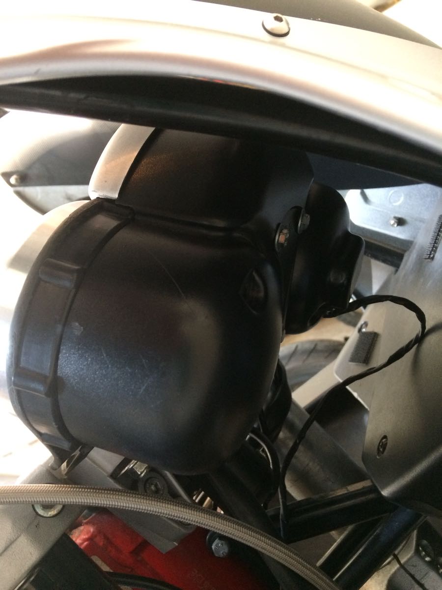

So, as near as I can tell, the sensor as shown on page 1 with the magnet and reed switch does not work on newer programmable speedometers. I bought the Dakota Digital pulse generator and it worked from the getgo. I cobbed the supplied 7/8” fitting to attach it to the gear drive. A better way would be to buy 7/8” alum hex stock and tap either end with 16mmx1.0 thread on one end and 5/8x18 thread on the other. This fitting needs to be no more than about 1” to clear the throttle body linkage. To install, the plastic socket of the ball and socket linkage join snaps off. To attach the gauges the supplied threaded collars are used on the factory bracket, and the front (back???) shell is relieved with a coping saw and Dremel tool. Three bolts secure the shell and engage the backs of the threaded inserts used for the center light stack.
